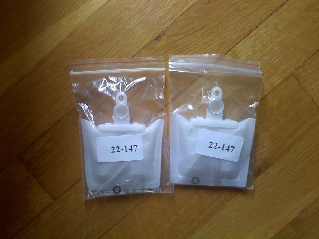

When I took my fuel pump hanger out to inspect the fuel pumps today I saw this:
'The filter of the 1st fuel pump was bent upwards...maybe due to bad installation
and lack of space (for 2 pumps) into the fuel tank'. The bent filter might cause bad restriction
to fuel flow as well as fuel sturvation...'my two cents'.
I think that this might be the reason of fuel pressure drop and lean conditions..
What do you guys think? :cry:

looks like it hit the anti spash well wall in the tank. will take a bit of fooling around and twsiting to get it in right spot, but thats a 3d fileter, and will suck gas from top and bottom, so not to critical.
also were you running twin pumps before? or is this new? afrs were ok before the new pumps??

the tanks are vented so they dont pressureize or create vacuum, though lack of gas isnt good. i always run my tank from full to 1/2, as fuel weight is not that much, and the fuel also cools the pumps, so i keep them submerged.
the filters on the pumps are just to keep dirt and junk out of the pump. if the old filters look good and not to dirty, just re-use them if there shorter. can also clean them with compressed air.

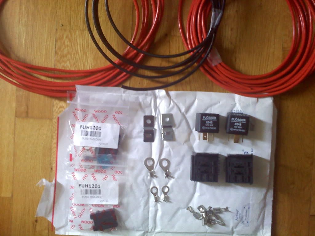

About the wiring- I am running a 8AWG amp wire that splits to 2 12awg wires (and seperate relays triggered by the stock wiring) feeding each pump with an 8gauge ground wire for my a aeromotive 340 pumps! Overkill- maybe, but fuel pumps love good clean battery voltage and you're choking them by using the factory wiring. Also, the factory wiring is 14gauge at best so 2 walbros will pull enough power from that wire to make it get warm-maybe even hot!
Do yourself a favor and run some new wires to the back of the car to feed your starving pumps :p
Also, you'll have to rotate the pumps so that both pickup socks lay as flat as possible- this is nother thing that can caused problems by making the pump suck air and making the other pump work harder.

And got two new pump filters that were installed better this time without bending or any issue of that nature.
AND PEOPLE...I did change the wiring setup. Pumps now get powered directly from the battery (+12V)
I will make a new thread about stock toyota wiring,that is in fact not capable to power correctly 2 high performance pumps.
