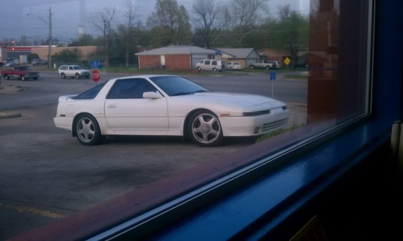

suprarick
May 3, 2007
68
Texas
I think they look decent enough without spacers (not to mention it's much safer). The pics above are my blue 87 without spacers. Definitely better than stock steelies lol. But yes, having spacers does look a bit more "flush."
