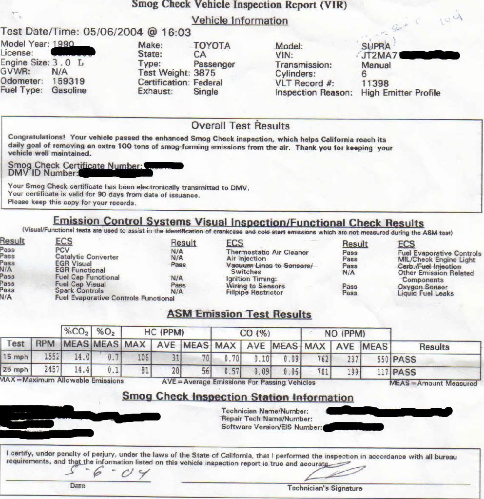

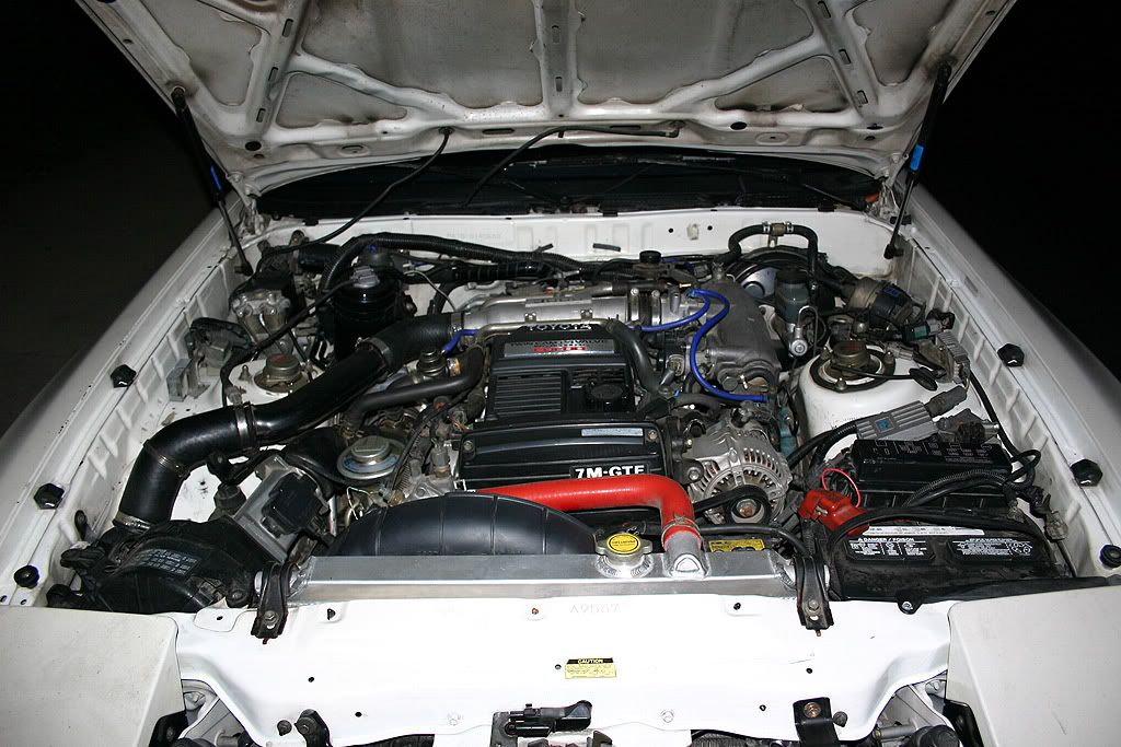

Here is my old smoggable setup (taken the same night as my smog check):
Specs:
- TO4E-60 Trim
- Greddy Intercooler
- RC 550s
- Lex AFM
- 18 PSI
- 3" turbo back exhaust (3" DP to HKS Twin Tip 75mm)
- 3" cat
- SAFC (hidden in glove box)
Technically, the Greddy intercooler kit is not legal. But the SPEARCO intercooler is legal, so you can substitute that.
As you can see, as long as your engine "appears" stock, they will not investigate too far.
While I never dynoed, the setup should have been good for 400HP.

Afpr and bov are not required to make 400HP, so I would leave those things off for a smog legal 400HP project.
Ss for the visual, if you have a 3" turbo back downpipe, most places won't look that close.
If they do, you can always find another shop around the corner.
