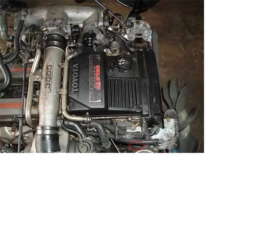

The hose I'm talking about can be seen here I have it circled. In red it's by the P/S Res the lower one. This may be the one previously attached but I couldn't really see much where the shot was taken from. So sorry if it is the same hose. BTW not my engine. I haven't had time to take any pics yet. Two jobs and college is taking my time. Bill.

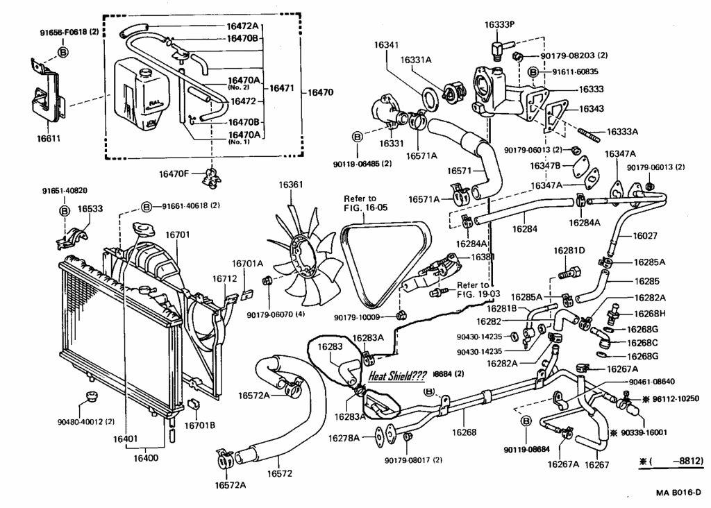

Well after a little more searching I found the entire Breakdown map for the hose I'm looking at. 16283 is the Part Number. It looks like I can see the heat sheild your talking about. I'll check to see if I have that or not. I don't recall seeing it but I was in such a hurry I didn't really look for something like that. I'll prolly just wind up putting some heat wrap on it. Thanks Bill.

Yea only place I have ever seen one is in pictures on the net. Every supra I have ever seen in person is missing that sheild.

I CAREFULLY bend it out of the way to install that hose as I have never found a way to get a hose clamp on it without getting that sheild out of the way...
