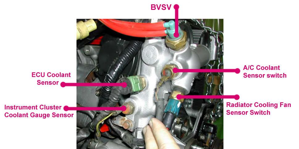

OK fine, I'll bite. You will not get an accurate water temp reading on that side of the thermostat as that is not true engine coolant temperature. Same thing with the radiator hose adapter pieces.
As for your charcoal canister.... Buy a 1JZ charcoal canister and tuck it in the fender. Problem solved.
This should help your cause:
That will highlight all of the sensors in that housing, notice the ECU needs a coolant temp sensor. If you want to remove one, make sure you remove the one for the gauge, which is the smaller one..
::edit:: JJ, I agree with you and I'm NOT a pilot ;)

So get an adapter that will go into the Instrument Cluster coolant gauge sensor (Whatever thread that is to 1/8 NPT) and ill be good?
Thanks for the help guys.
Do any of you know what the thread style is for that?
