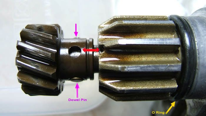

Just an O ring Toyota part # is 90099-14018 you will need to check your timing after installing the distributor. This may help Link and the pic below.

Just out of interest: the gear on the end of the distributor or CPS meshes with the exhaust camshaft helical gear, but what does the large fluted section do that looks like a gear? Is it machined that way for an oil pathway?
Poodles
I play with fire
Jul 22, 2006
16,757
Fort Worth, TX
Doesn't mesh with anything, never really knew why it was make that way, but the oil pathway sounds about right as the o-ring would dry up without it...
