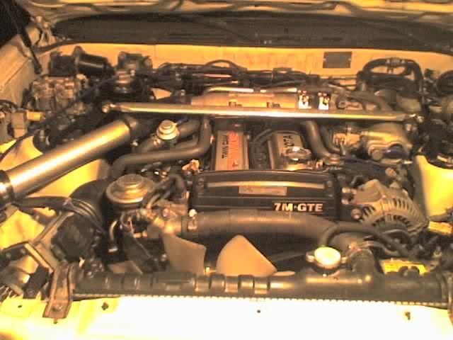

ive made two set's of wire's using the stock stuff, i didn't know they had aftermarket plug boots that could be purchased, i might look into this aswell and make my self a set of 8mm wires.. im currently running old stock 7mm, it was free so i didn't care to much but my car has a miss and it's buggin me, i think it's a dirty coil pack connection ....
here's my bro's car w/ wires..
