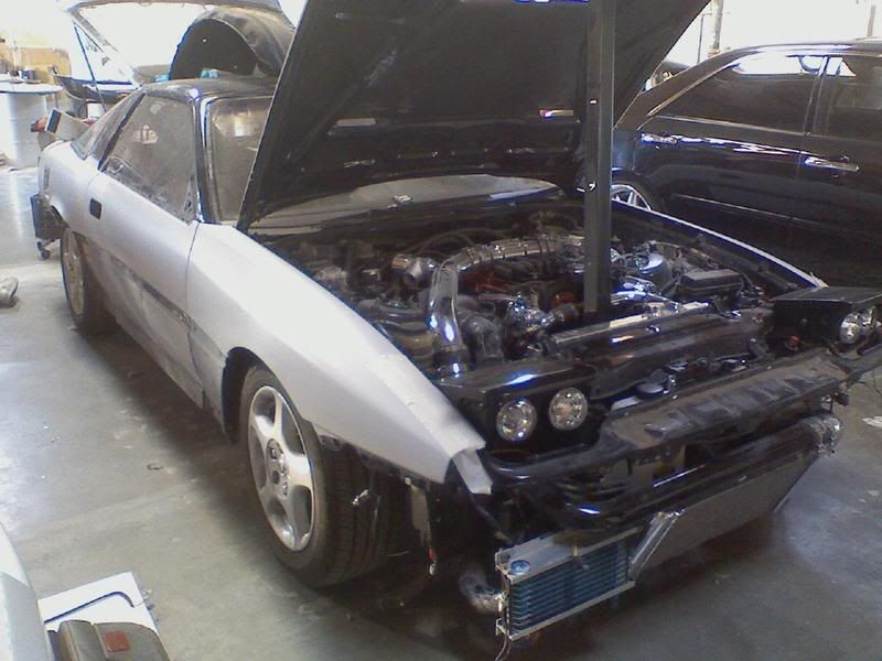

Im working on getting the car ready for SILV08. Kaizen performed engine maintenance and installed some aftermarket parts. Most importantly, it took only 3 days from the time they ordered my AEM EMS to the time they got my car dyno tuned.
Phase I, engine tuning, is complete. (Next, Phase II, is paint.)
Engine Specifications:
* 7MGTE
* JE Pistons (thermal barrier and solid dry film coated by High Performance Coatings, Inc.)
* JET-HOT 2000 Ceramic Coated Exhaust Manifold
* HKS 1.2 Bead Metal Head Gasket
* ARP Headbolts/Main Bolts/Rod Bolts
* AEM Adjustable Cam Gears
* Fluidyne Radiator
* FAL Dual Electric Fans
* Greddy Type-S BOV
* Greddy Oil Cooler
* Unorthodox Water Pump Pulley
* Unorthodox Crank Pulley
* Unorthodox Power Steering Pulley
Turbocharger & Induction: CT-26 upgraded to 60 trim by Turbonetics
3" Exhaust:
* Supraport Turbo Elbow
* Randomtech Downpipe
* Burnsstainless Exhaust
* EF Madness (Ernie Fixmer of Kaizen) Test Pipe
Fuel & Tuning:
* AEM EMS
* RC Engineering 550 Injectors
* Walbro Supra MKIV Fuel Pump
Gauges
*AEM Widband
*AEM Serial Data Stream
Dyno Results:
With S-AFC & VPC setup with 8lbs boost: 281.7hp, 287.9tq
With Aem Ems setup and 16lbs boost: 365.6hp, 373.4tq
Pics and vids from the dyno tuning session. Phase I is done for the SILV08 build. The build is 33.3% complete. Thank you, Kaizen (Jose, Ernie, AJ, Ray) for the engine work and bisimotofor dyno tuning.

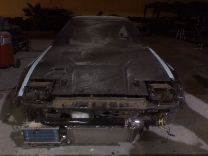

Last round of modding before Vegas. Aiming for 400RWHP
This should get the job done...
PSYCHE!

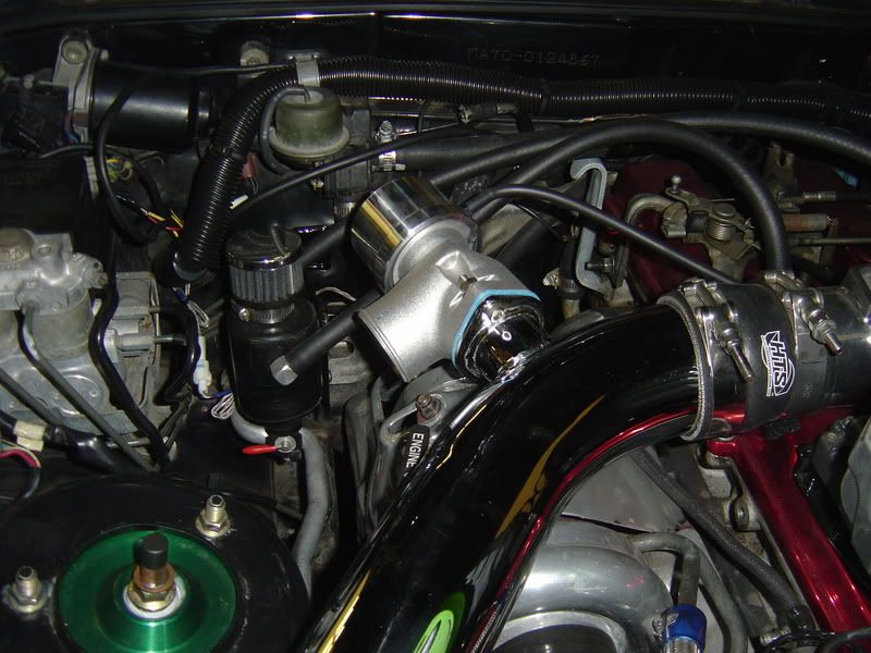

Huh? where did it go?
Duh! Replaced the Type-S with a Type-R
AEM Serial Gauge for use with AEM EMS

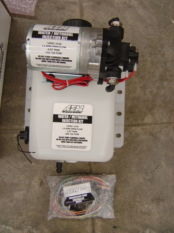

Water/Methanol Injection
55
How is the meth injection install coming? Where did you buy your kit and how much did it cost? Thanks, good luck with the meet.

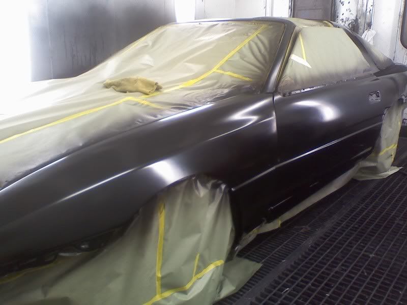

Paint job/body work progress

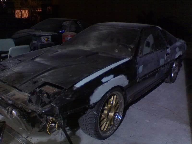

Fender work to get 19x9.5 +24 in front and 19x10.5+18 in the rear. Little dents needed fixing.
Removed as much as possible from the car

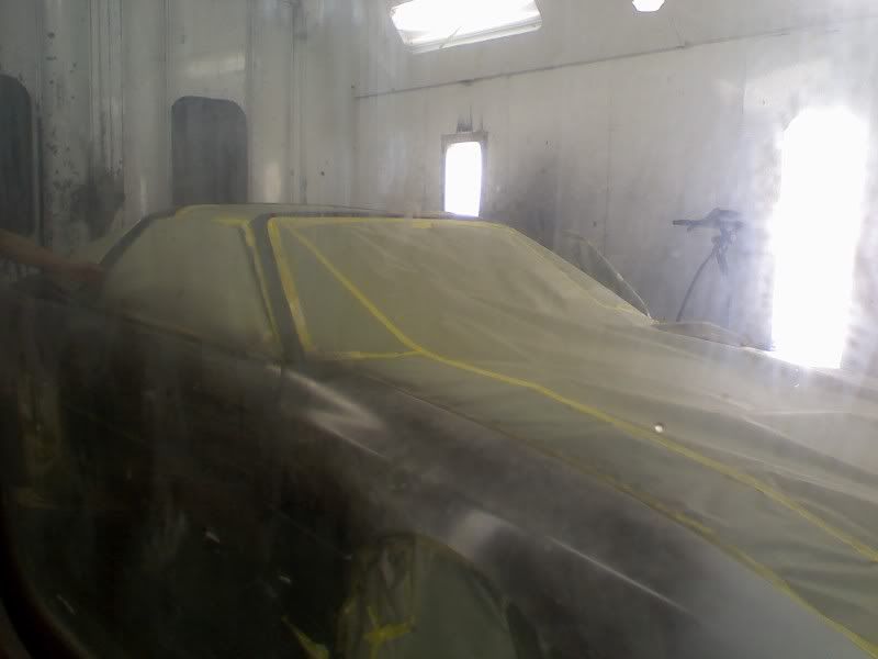

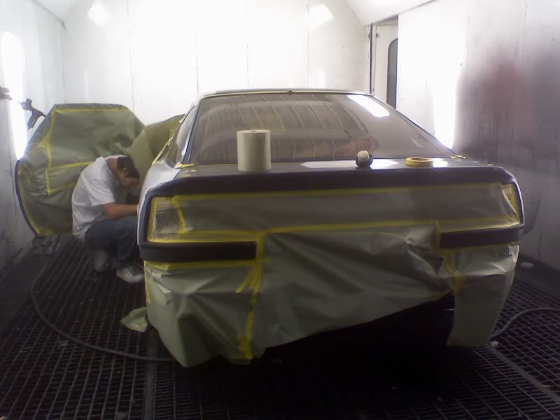

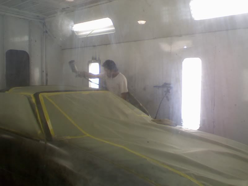

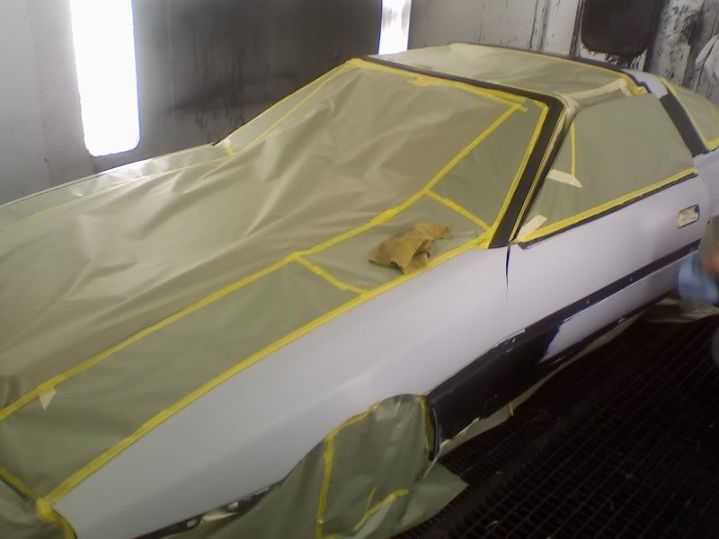

Makito masking away
Makito applying the base coat

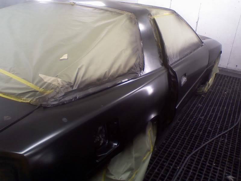

Satin black!

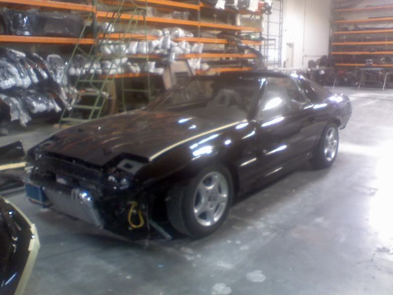

5
SoCal

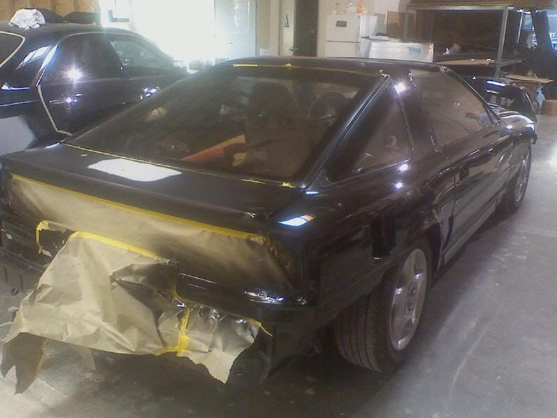

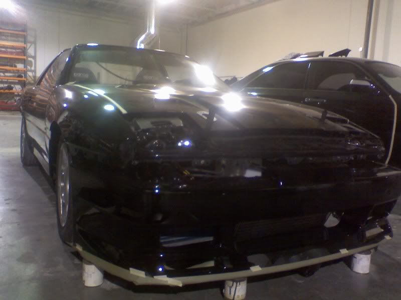

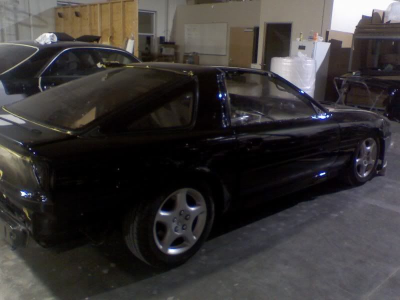

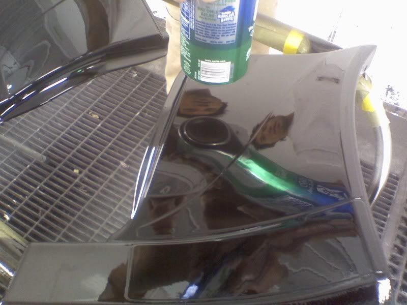

3 more coats of Mercedes black (no pearl, no metallic, just black) and 3 coats of clear = no more satin black. Sorry for the poor cell phone pics.
Hatch is not painted yet because holes need to be filled in.
CF Hood was not painted because it will be "ghosted" instead. Ghosted? Stay tuned.

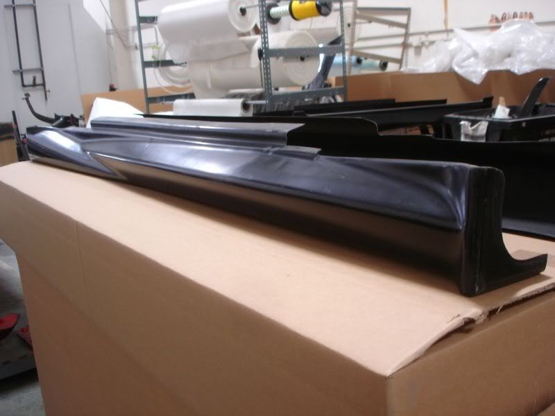

Thanks for talking the time to view this thread, everyone.
Gotta paint:
Ganador Mirrors
Kaminari 3 piece
Ablug rear
Ablfug sides
Then "integrate" the diffuser

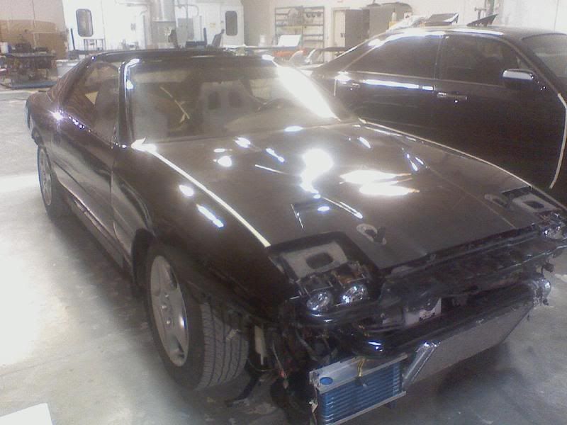

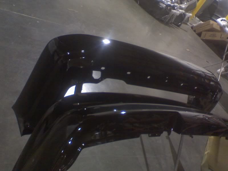

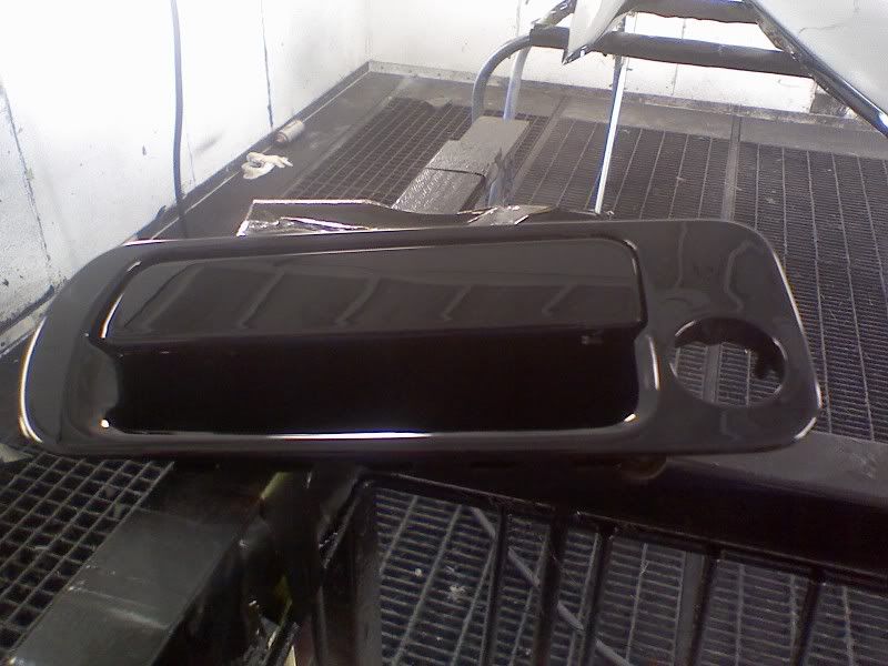

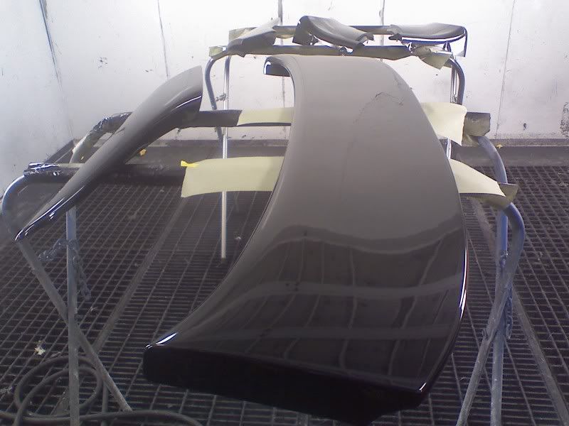

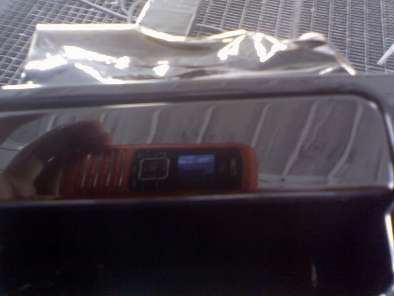

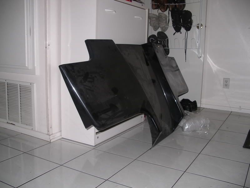

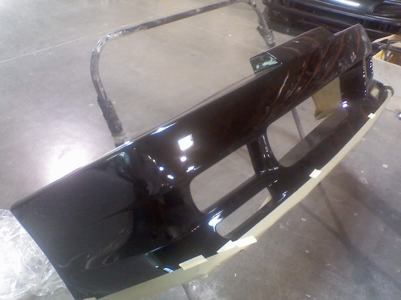

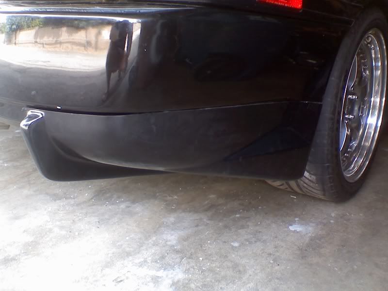

Dropped by Seven Apple to see the progress and took some pics. Seeing the painted parts makes me not wanna install them on the car...just hang them on the wall. None of the parts have been polished yet.
Meet the painter, Makito, aka Seven Apple
The reflection from the pic above is from the Kaminari wing

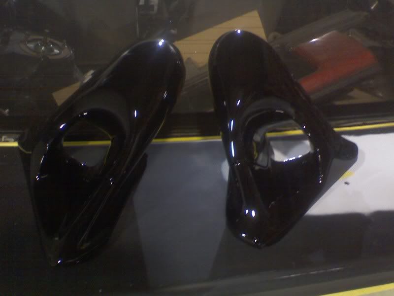

Front and rear bumpers are done
Ganador mirrors are done:
Door handles are done
Rear quarter panels are done:
