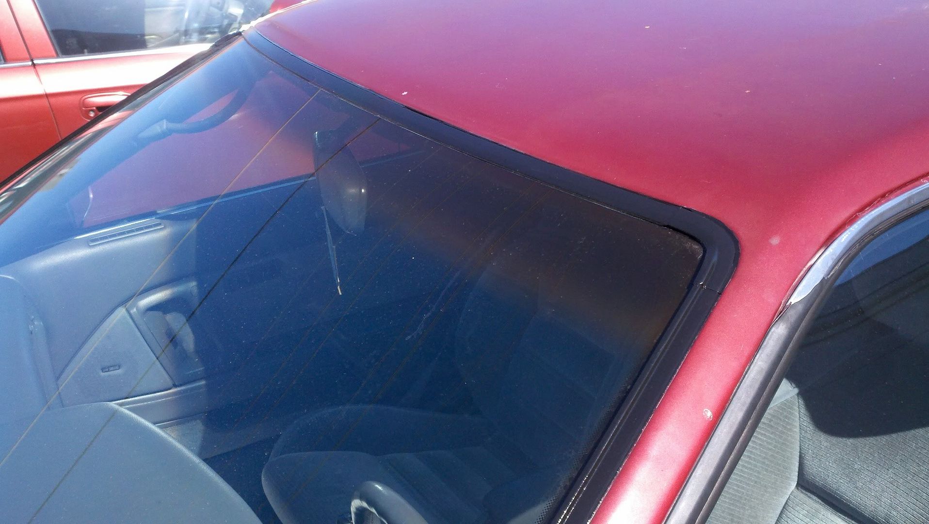

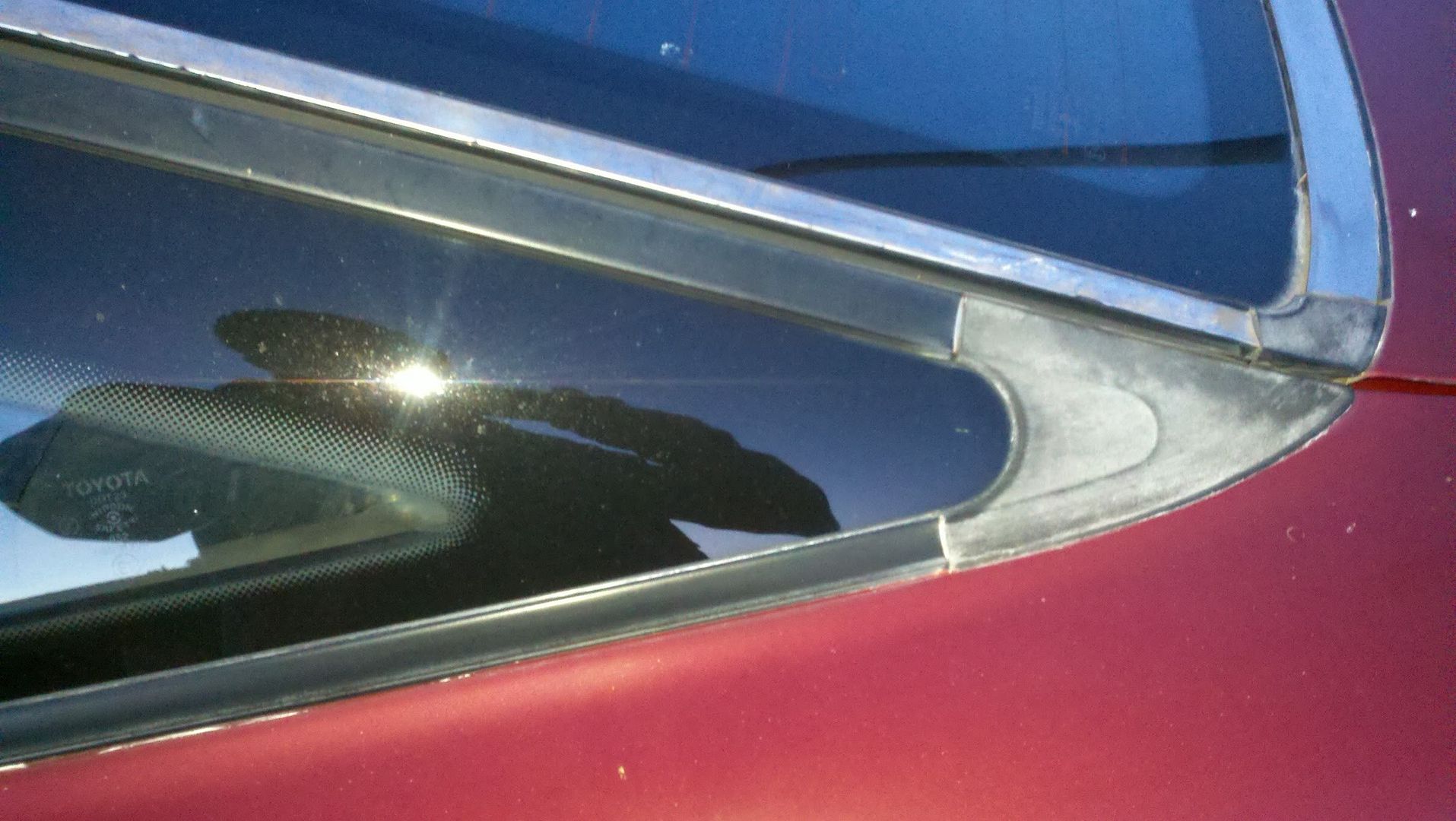

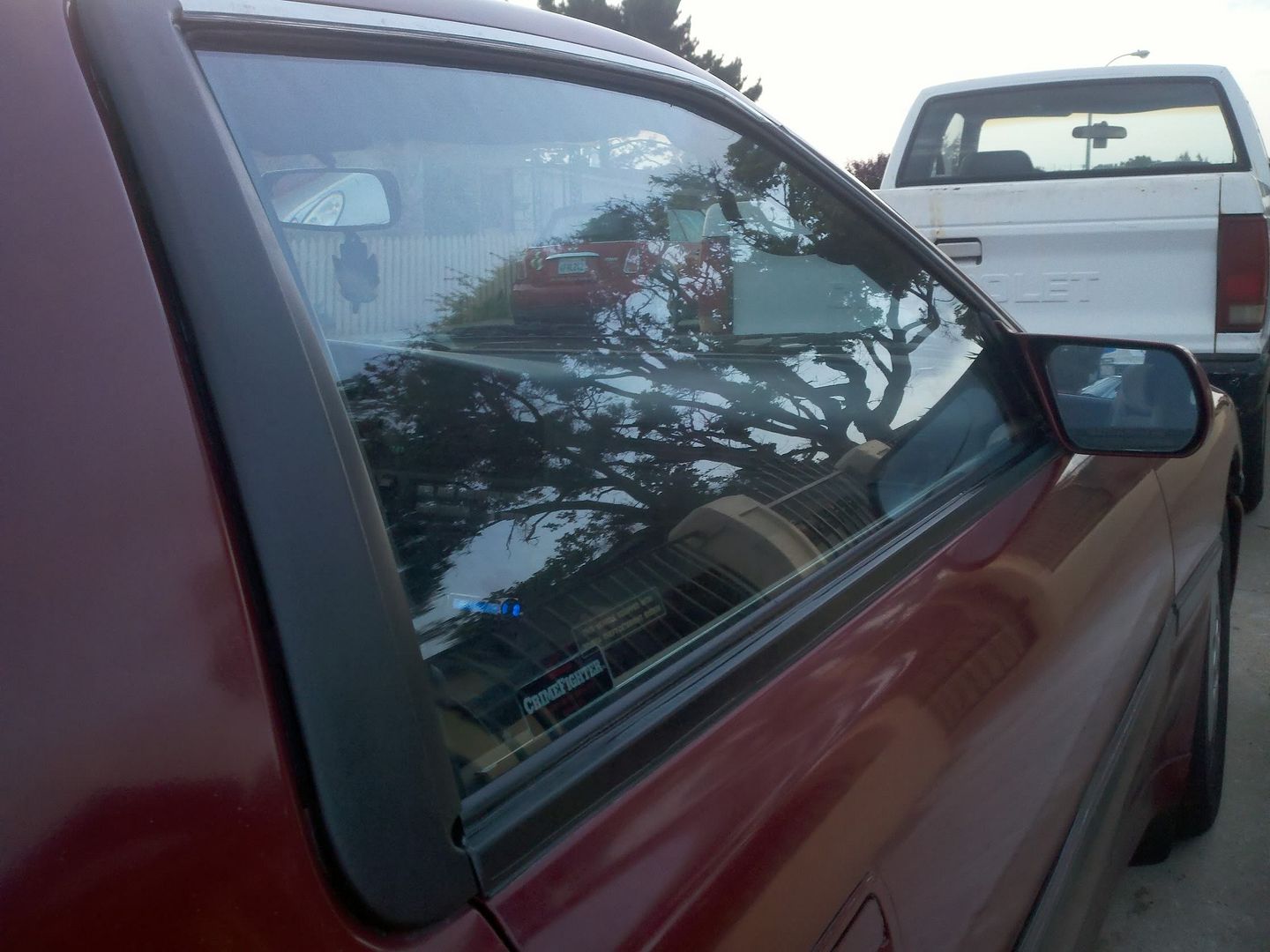

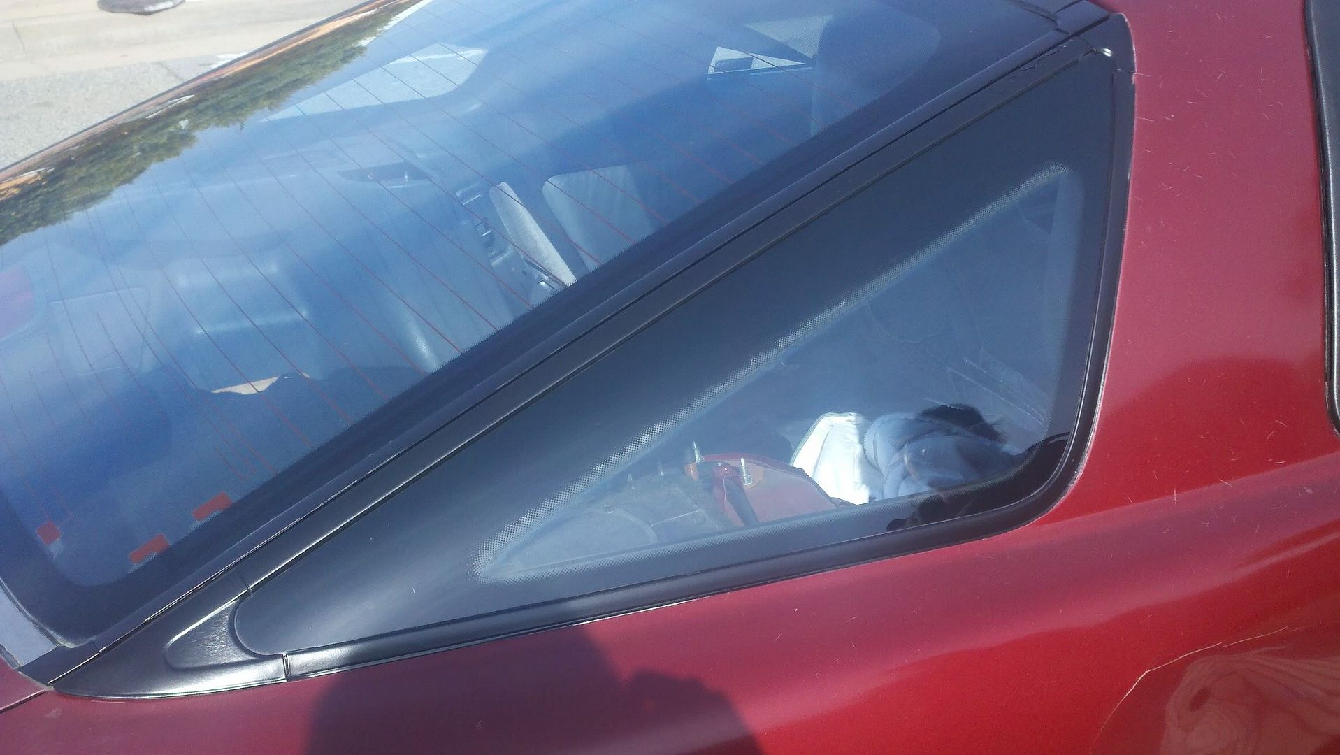

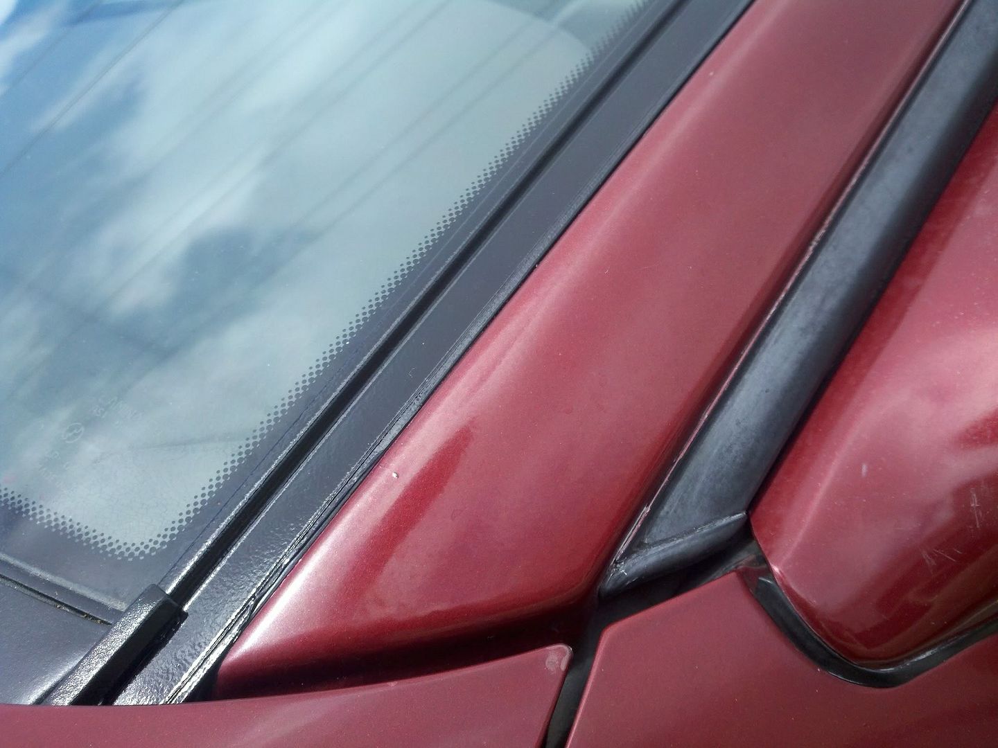

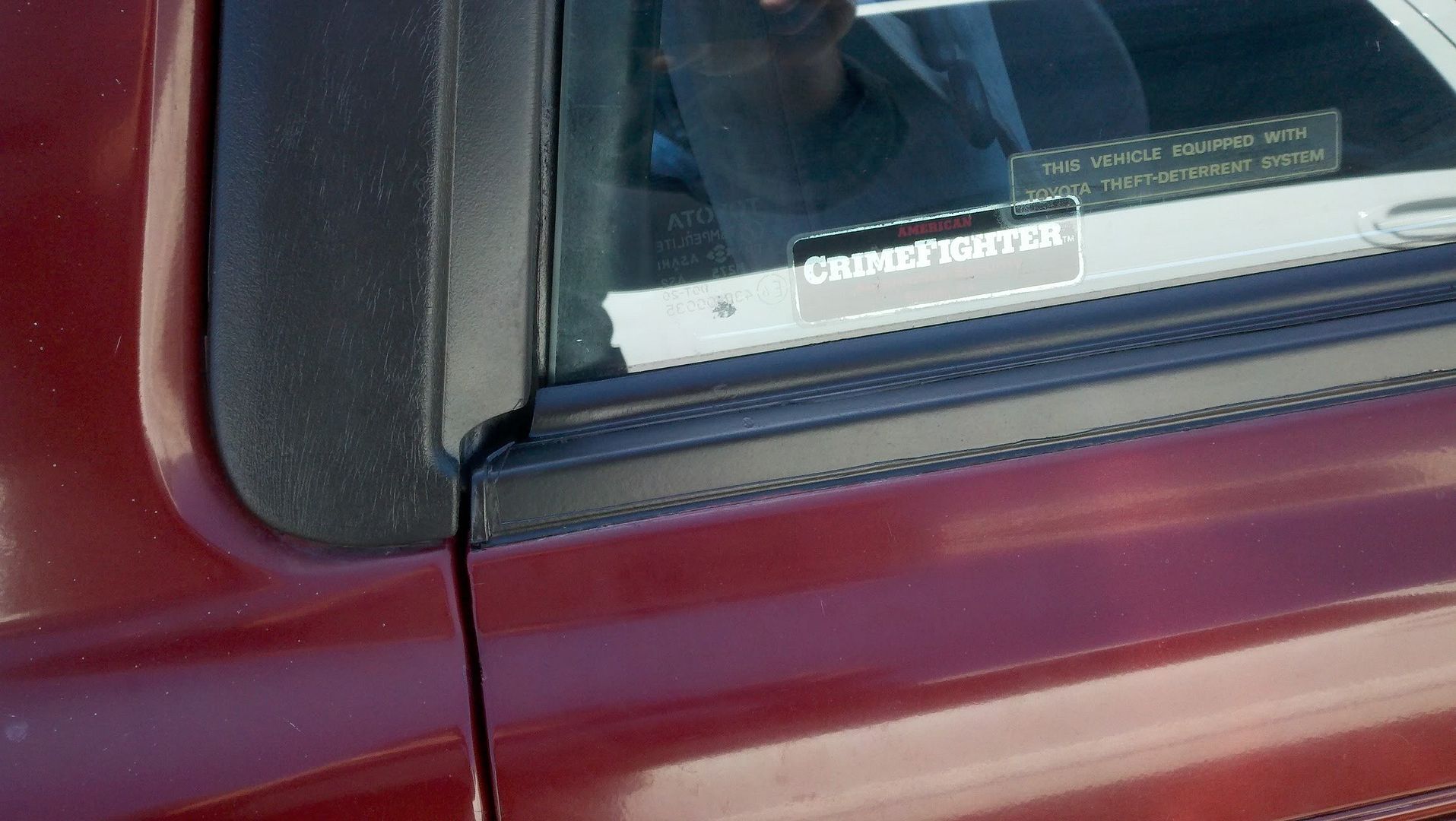

Something I did today in about an hour and a half. Plastidip, then some high gloss clear. Best thing is you can peel it of if you don't like it. If I were to do it again I would use some low gloss clear.
Clear
mecevans
Jan 18, 2009
1,295
M-bay, cali
Plastidip and clear was in a spray can. The lower windshield trim is just plastidip with no clear. It has a nice matte finish.

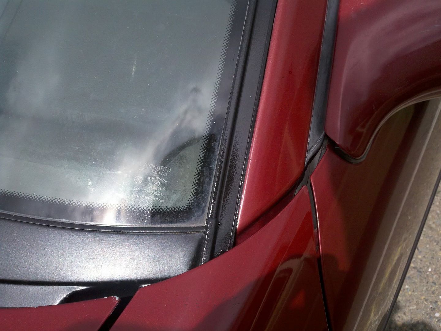

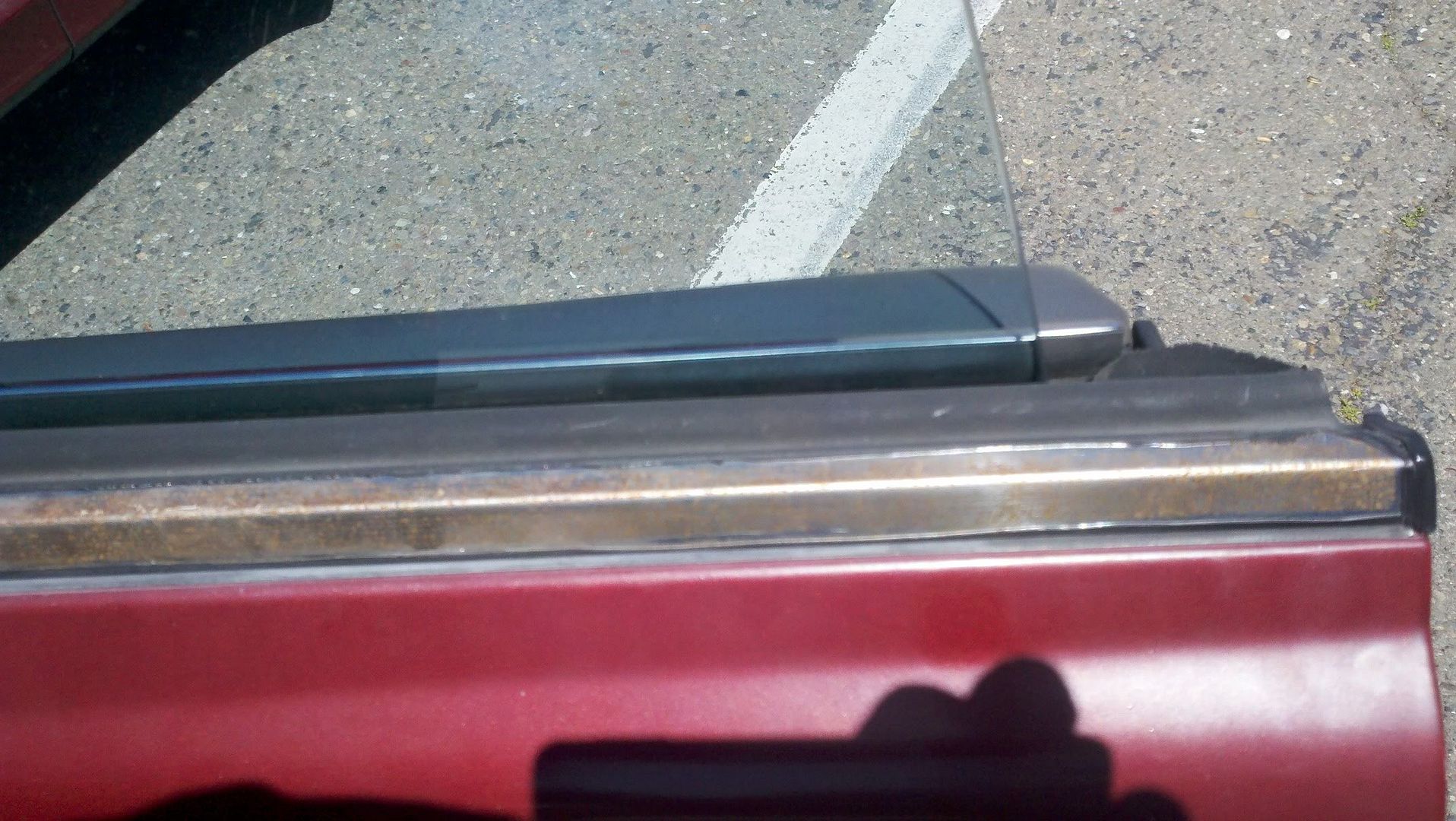

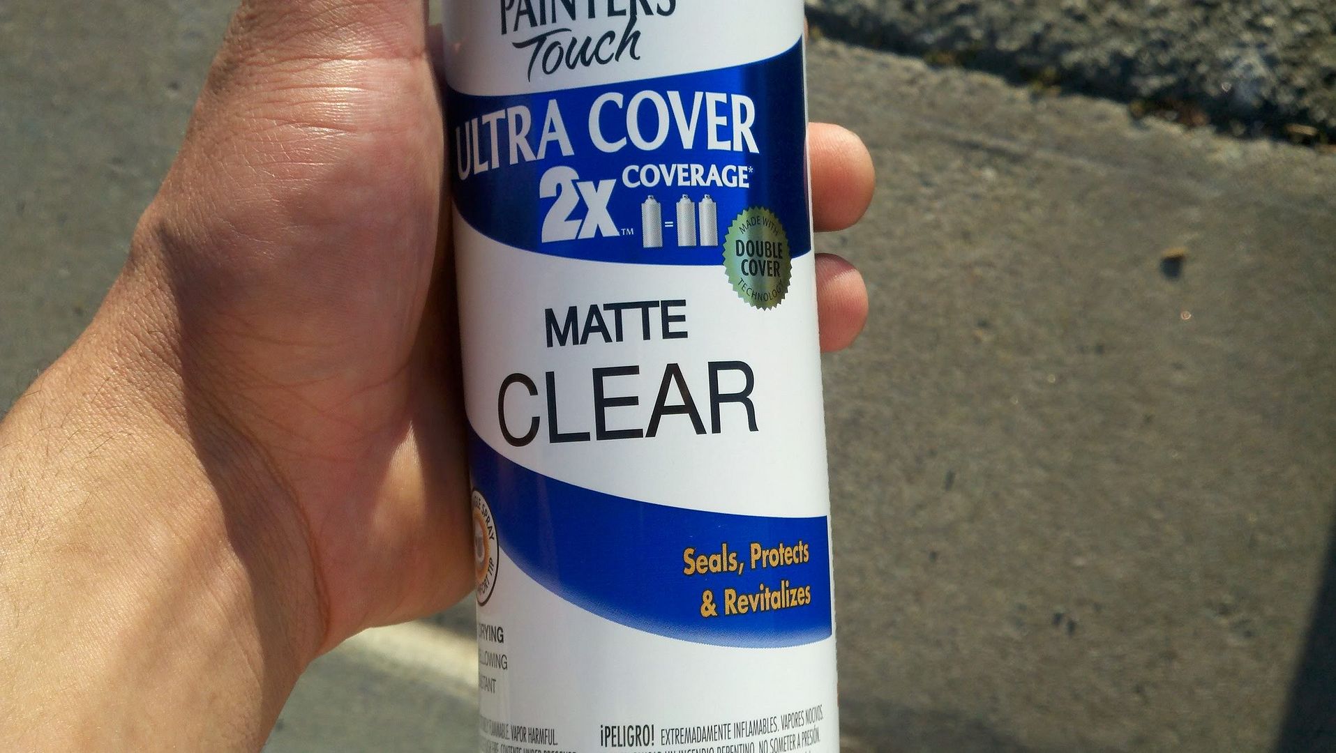

They should have it at OSH or the home depot. Im going to go to a couple stores to find low gloss or matte clear such as this...
http://www.krylon.com/products/matte_finish/
I painted the pillar and lower window trim last night. First I got a sharp hobby knife and cut the flaky molding back. I left about 2-3 mm of material from the seal. No clear. Yet.
