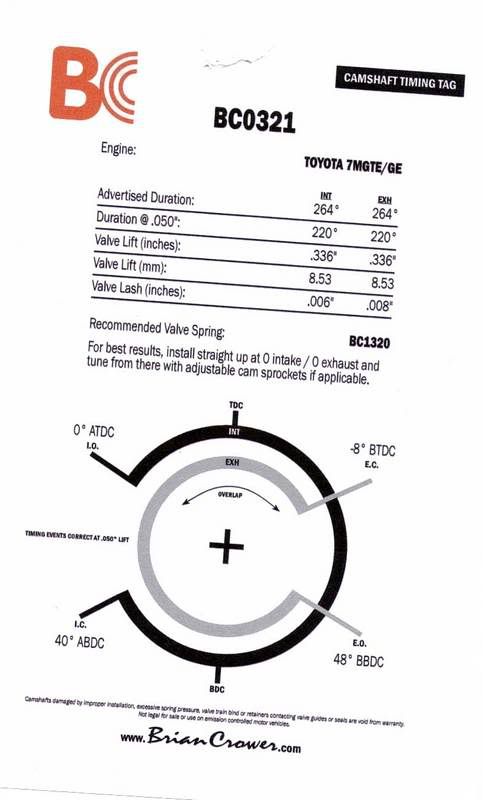

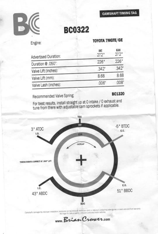

i lost my timing card does any one know the spec thanks
NashMan WTF did he just wright ? Aug 5, 2005 4,940 17 38 45 Victoria BC Jul 2, 2010 #1 i lost my timing card does any one know the spec thanks
NashMan WTF did he just wright ? Aug 5, 2005 4,940 17 38 45 Victoria BC Jul 3, 2010 #2 some one has to know the spec's ..........
empera Authorized Vendor Mar 30, 2005 4,548 0 36 42 Philly. Jul 3, 2010 #3 i should still have my card...i'll try to get it later today and snap a pic or scan it
NashMan WTF did he just wright ? Aug 5, 2005 4,940 17 38 45 Victoria BC Jul 3, 2010 #4 plz do man that would be awesome
NashMan WTF did he just wright ? Aug 5, 2005 4,940 17 38 45 Victoria BC Jul 4, 2010 #5 if any one els has this issue says thanks to empera and here is the 264 timing card as well i think this should be sticked because BC cams does not give the spec's out on there web page and there no inof on the net that i could find
