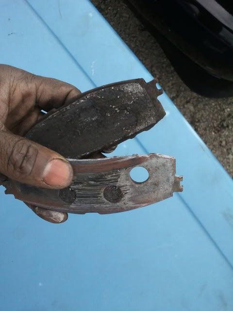

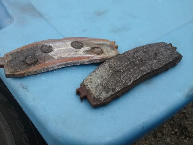

100% with poodles. The stock brakes just don't hold up. Slotted and drilled All the way around with porterfields. They are 100 times better then OE. autozone / napa pads and stock rotors but dep on the track be ready to have a pucker moment as you over speed a corner. Im gonna post pics of my rear brakes after 1 day at the track. They were stock rotors with rs4 pads.
https://picasaweb.google.com/lh/photo/ABDyyqwD9hjdLujI-rZwUdP5P2CEKT9e4411mvCdK24?feat=directlink
https://picasaweb.google.com/lh/photo/v-5CaWMvi31PsQ4HQfPY69P5P2CEKT9e4411mvCdK24?feat=directlink
https://picasaweb.google.com/lh/photo/5JQ7uTv3CVPhX2C0TN5CidP5P2CEKT9e4411mvCdK24?feat=directlink

1-2clutch-u: How old were those brakes before the track abuse? It looks like you might have had all that rust contributing to the pads debonding... in addition to the heat of course.

yea the rotors were old but the car sat for awhie b4 I took that pic got a lil lazy then got into a hit n run in my civic. here are pics of the o.e pads after 4 20 min sessions.
