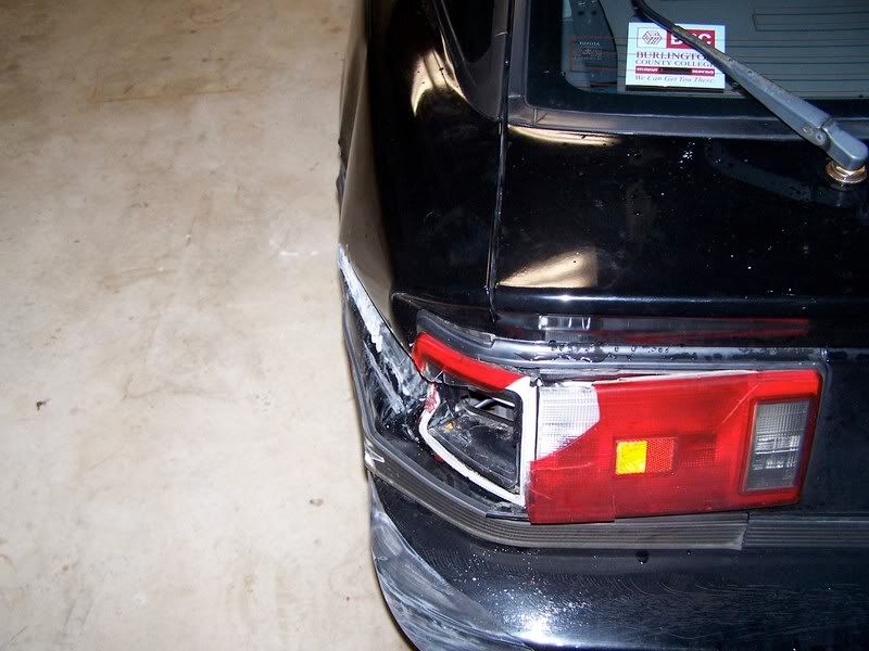

a few weeks ago i slid into a guard rail, i was being stupid, but that's not what the thread is about...basically the tail lights worked after the accident but it rained a few times and the car was outside, nothing i could really do about it (looking back, i should've taped the tail light or something) and now my brake lights don't come on, none of them
here's the damage, so i'm not tearing the car apart, is there a relay or anything back there that may have water damage?
