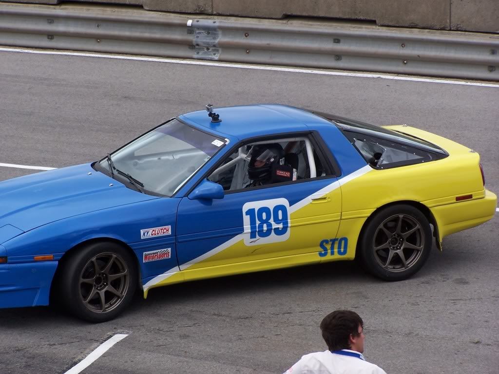

naca ducts mounted in lexan in the quarter windows for the rear. for the front they are ran from holes in the bumper. the front is the easiest to run however you have to wedge the hose between the sway bar and tierod. aircraft spruce sells aluminum flange adapters that work well when bolted to factory dust shields.
you can see the rear naca ducts here. note they are duals only so i can run one to the differential

I made them of course lol. I would measure your rear rotor temperatures before adding the ducts in the rear however as my rear brakes are now over cooled.
