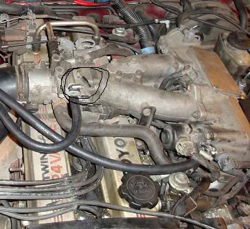

:sarcasm:Sorry, you said intake plenum, and I thought that that's the plenum and saw only this port, so thought you ment this port.
~0,7bar vac on cold start idle ok?
When pressing the throttle it goes deeper into vacuum, is that normal? ( I thought it should be less vacuum?)

Not a problem...I can see why you thought that. As for vacuum (technically there's no such thing but we won't get into that) yes, as airflow into the engine increases it should be less. In other words pressure in the manifold should increase in the direction of atmospheric. The only time you should see deeper vacuum than idle is when the throttle has been open a fair bit and then snapped closed and even then that'll be momentary.

So 1) I have a problem somewhere?
or 2) The gauge is crap...
Any better ports to stick the vacuum hose in? ( I looked, didn't found any... or are there nice ports underneath the intake?)

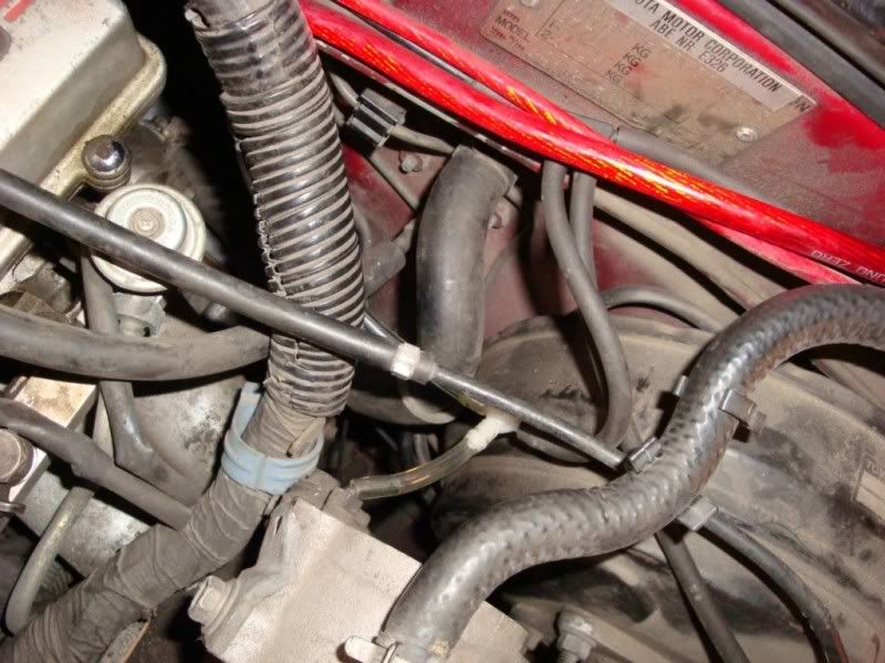

Any line that has vacum 100% of the time is fine. FPR, Cruise, Heater VSV, ect. Even the brake booster line before the check valve.
