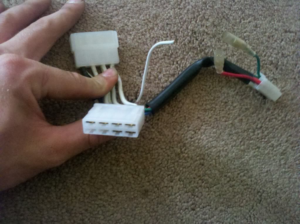

i recently bought a blitz fatt turbo timer off another member on here and it came with an adapter harness but either im blind and/or retarded or the harness's may be year specific because i cant seem to find where to plug the damn thing in...any info is greatly apreciated

Yep...pull the lower cover off under your steering column and you should see the ignition harness coming from the column. You unplug it and plug this harness in between the two connectors putting it inline to the ignition harness. The smaller connector goes to your timer, of course.

I have the same connections on a used Blitz timer, and felt like a retard too 'cause I couldn't figure it out. This thread totally just answered my question. Gonna try to hook it up tomorrow morning. Thanks!
