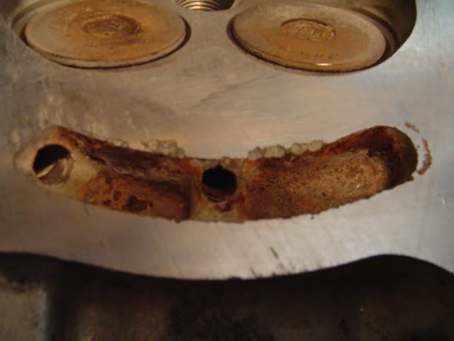

One of my exhaust coolant passages near cylinder 6 was eroded away, I was paranoid at first, but it held up fine. But I wouldn't try it on a MLS head gasket. Just trying to state that it can be done without welding, depending how bad it is eroded.

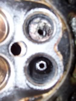

i forgot to say that the machinist was saying that the head was in really bad shape. i was looking at the exhaust ports and on chamber 3 and 5 only one of the ports on each chamber are full of carbon build up and dirt but the vavles that go in those ports arent chipped,infact they have less carbon build up then some of the other valves. im going to try and find another machine shop to see if they can do the welding but as for the port and polish i'll look into that as well. what is a "MLS" headgasket? im going to be using an toyota oem headgasket.

Here's my #6 cylinder's coolant passage, exhaust side:

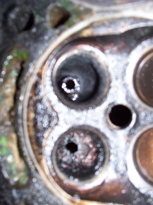

my coolant passage is pretty bad heres the first pic

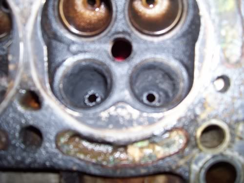

another area of erosion
heres the carbon build up in the port on combustion chamber 3

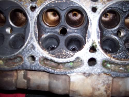

chamber 5

I'm no engine building expert but I can lend some advice... Until you posted pics I would have suggested getting a second opinion. However, those coolant passages do look severely damaged and the corrosion has effected the area on the head gasket surface - the achiles heel of our motors. If you are thinking about having that head repaired, which it needs to be if you use it, consider the rest of the volume of the coolant jackets that you can't see....it will be heavily corroded there too.
Used heads in good shape isn't too expensive if bought from a forum member, and you wouldn't have to have the jackets repaired, so you can remove that machine shop cost. that fully rebuilt/remanufactured head from the shop doesn't sound all that bad.
