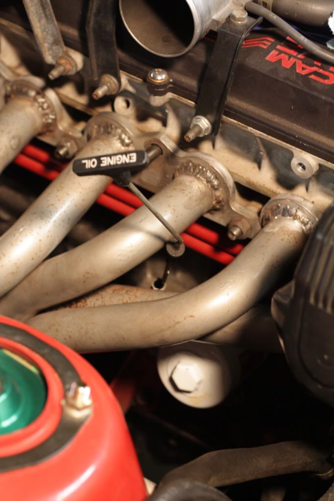

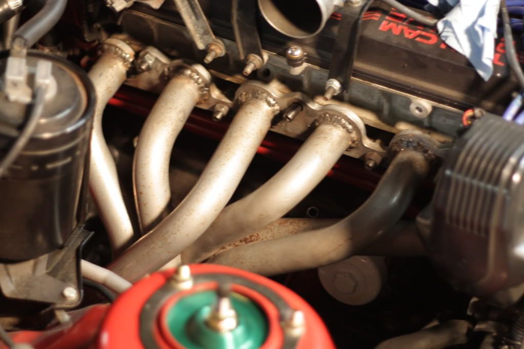

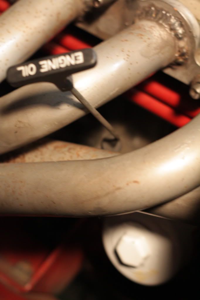

I've had to rotate my dipstick tube 90° counterclockwise to clear the new manifold, but now the dipstick runs through runners 2 and 3, rubbing on 3. Can I bend the dipstick to clear the runners without touching, or will the heat hurt the dipstick handle/seal or other parts? I'm either going to have it recoated with ceramic or wrapped and sealed, but still worry about this part. Any advice?

I would definitely wrap that manifold if you're going to run it that way. Or buy a universal dipstick with the longer flexible tube.

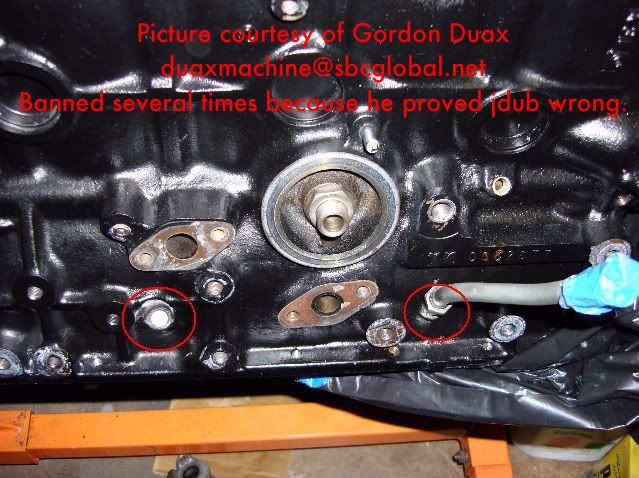

gofastgeorge
Jan 24, 2008
944
Texas
Clip;1480468 said:
george, what do you mean by the dipstick tube being ahead of the oil filter? as in not the same routing as mine?
Yup.
One of my blocks had the dip stick more forward.
And my turbo block had it back like yours, so I plugged the rear position,
and put the tube forward like the other one.
There is a spot in the casting for it there.
I just made a press in plug to seal off the rear one.

george, i spose i'll have to drill the forward position out?
