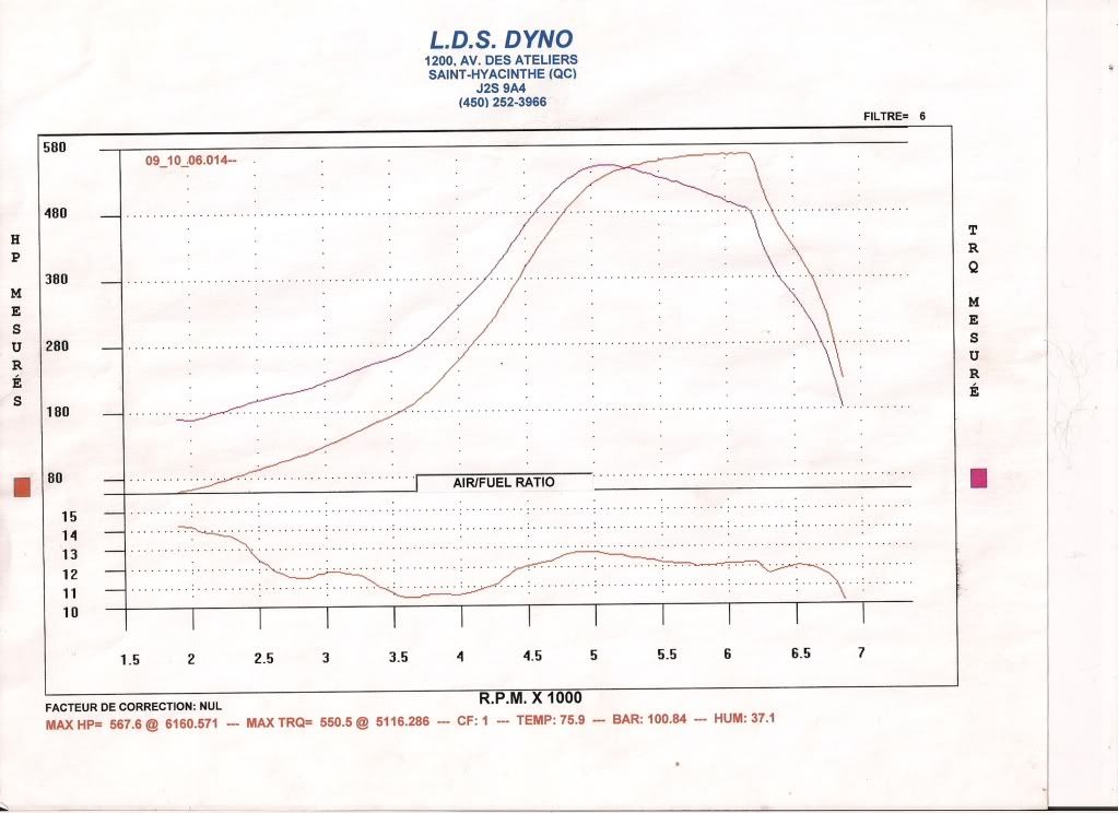

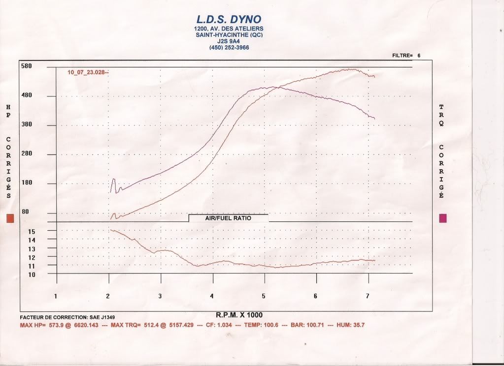

anybody have before and after installation dyno sheet,..cause i 've changed my cams for these cams but at the same time i've change from gt4088r .95a/r to gt3788r .89 a/r and i lost power,i'm not sure if it's the cams or turbo
gt4088r/stock cams/23psi:575whp 550wtq
gt3788r/bc 264 /25psi:574whp 512wtq

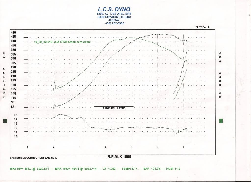

but now i've changed all my setup for faster response...gt3582r .82 a/r , spa cast manifold , jdm stock cams , 484whp 464wtq.
what do you thinks it will hapen if i reinstall my bc264 cams,in term of response , peak power , torque curve???is torque and hp will be raise

I have a ported/polished head and BC264's on stock twins. Has a really healthy powerband from 2500-5000, but flattens out at 5k. Still pulls real nicely from 5-7k, but doesn't make any more power according to the butt dyno. Yes, you lost power, but I wouldn't be so quick to blame the cams. How's the response? How high are you revving it anyway? You're the one providing the numbers, do you have any graphs to give us ideas of your curves?

gt4088r , stock jdm cams , 23psi not the final sheet....575whp
gt3788r , bc264 , 25psi
now i have gt3582r,what do you think it will happen if i put my bc264 , will i lose torque , response , for only raise about 20 peak 7000rpm hp?
