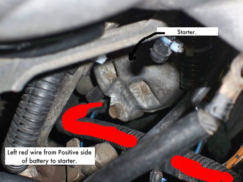

Quick synopsis -- Original 7MGTE, swapped in JDM 7MGTE. ECU, harness, fluids, etc ready. Attempt to turn motor over, but nothing happens. Have power for headlights, sunroof, interior lights, etc but no power to power windows.

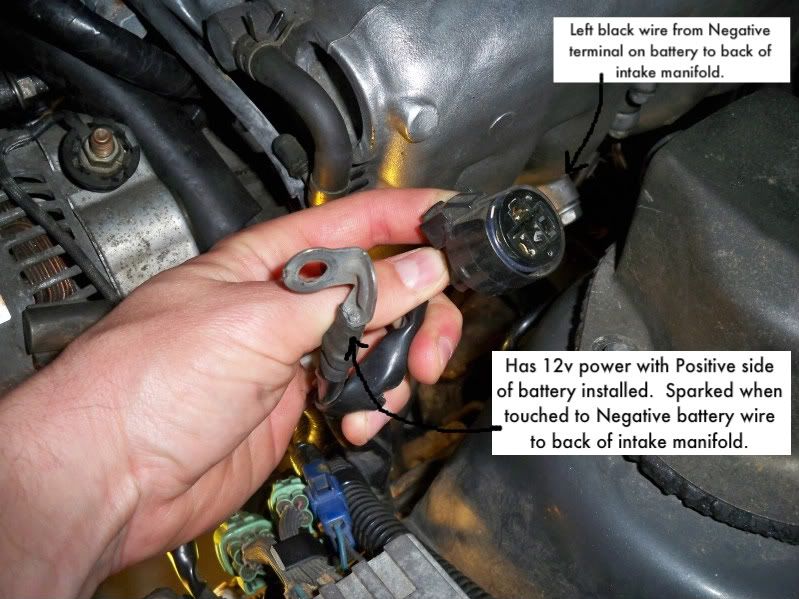

Questions -- Do I have the battery (both ground and power) wires correctly installed (I know the right ground wire should be grounded at the hole to the right of the diag. box, but I moved it to fit the Optima battery temporarily)? Do I have the starter wired up correctly? What is the black plug, Where does the black plug go (Looked at my TEWD book, Duh! It's the alternator wire!)? Please see the below pictures.
How I have battery and starter wired up currently... Answer: Per 90mkiiisupra400hp, JJ & the TEWD - Power (red wires) wired correctly; Ground (black wires), left wire (bolted to back of intake manifold) should be bolted to the side of the block, right wire is correctly grounded (after being moved to hole at right of diag. box).
Close up of starter wires...
Unknown engine plug with questions on picture... Answer: It's the alternator wire / plug.

Iirc the left ground wire bolts to the block and the only wires that bolt onto the intake manifold are from the wiring harness, someone correct me if I'm wrong but I think thats how it goes.

The wire that sparked is the output for the alternator. It goes on the stud of the alternator. I don't know if you did the starter correctly. The wires are not interchangeable. The large wire goes directly to the battery, the smaller has a plug on it. That is the switch portion.
Understood and the TEWD states as much about the ground wire. I'll move the ground wire to the block. Would this be the issue, as I have power to most of the accessories (lights, doors, etc.)?
I realized this after posting and checked the TEWD (as I should have in the first place), but thanks for the help.

Did you try bypassing the neutral safety switch. Are both wires hooked up to the starter, I only see the power wire from the battery in the pic. there is also a brown? single wire plug the hooks up to it. The only other thing I could think of is doing the starter relay mod.http://www.supramania.com/forums/showthread.php?76403-Car-not-starting-randomly-READ-THIS-(30-Amp-Starter-Relay-Mod)&highlight=starter+relay That might be the issue but have you tried shorting out the starter solenoid to see if the starter is good.

To bypass the neutral safety switch, just unplug both plugs and connect them with wires? Both wires are hooked up. You can see the smaller, black/blue colored wire under the large black wire. The starter relay mod doesn't appear to offer a solution as my car doesn't make a sound or click when I turn it over. Just absolutely nothing. Not sure I understand "shorting out" the starter solenoid?

I may have missed it, but has anyone mentioned the possibility of a bad starter solenoid? Jack up the car, disconnect the smaller wire from the starter.. then get a test light and attach it to the wire and find a good ground. Have a buddy hit the ignition and see if your test light illuminates. If it illuminates, it's a bad solenoid and you need to replace your starter. If not you need to look at starter relay for sure.
I'll try this shortly and report back. Perhaps my starter is just dead? Not looking forward to replacing the starter while on the car though.

Test complete. Looks like the wiring and relay are good. So I need a new starter and will replace that Thursday.
