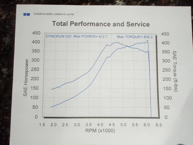

bad knock sensors on dyno? (pics/vids)

like jdub said but read the last bit ;)
The simple answer is timing is retarded depending on the severity of the knock. There are 3 levels: weak, medium, and strong but in no case will the retard correction angle exceed 10 degrees over calculated. When knocking stops the ECU advances timing by fixed angles a little at a time. This advance continues until knocking reoccurs. All this happens only in the knock correction range. There is no direct mixture enrichment. - JJ
makes me really want to throw mine on the dyno as im running a very similar setup as the op...

i see i must of missed that
***jdub shakes his head***
so retarding the timing i guess there is more unburnt fuel is why it sais its richer?
