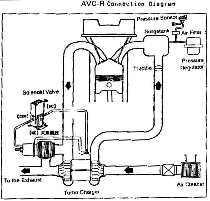

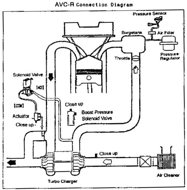

Can anyone tell me why you have to hook-up the avcr solenoid differently with an external wastegate than an internal wastegate?
internal:
external:
The big difference is that with the internal set-up the solenoid directly controls the wastegate and with the external set-up it acts as a bleeder.
Is this because the solenoid can't handle the bigger flow of air and higher boost which you get with a bigger turbo that normally goes with an external wastegate?
