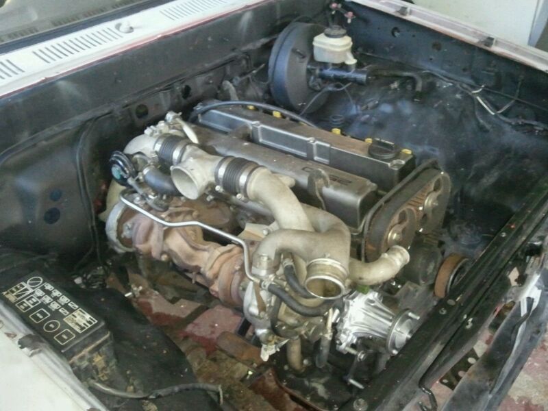

Thanks everyone. Didnt see the need of a build thread as this has been done a few times but heres a sample pic.
Maybe I will start a thread on here?? We'll see.
Anyways thanks again for the help everyone.
