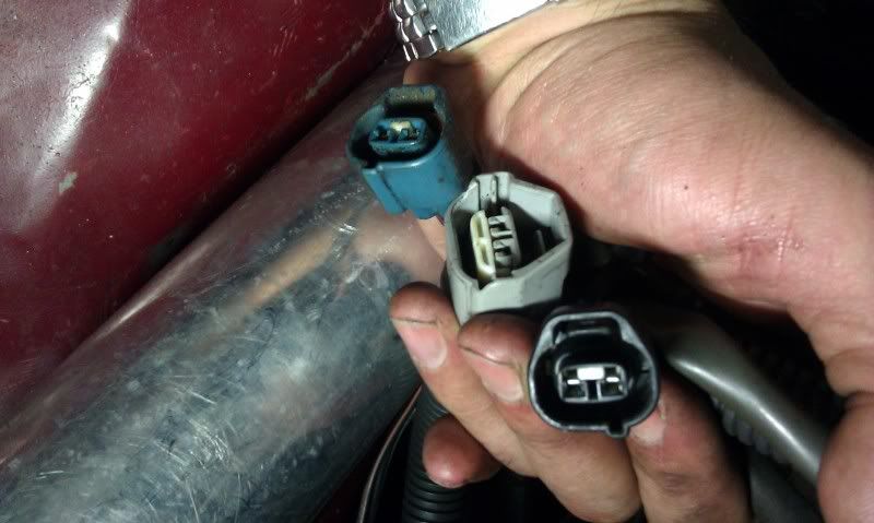

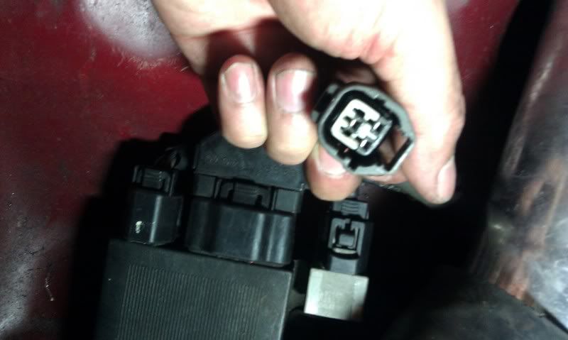

Trying to wire up my aristo harness and it sucks. I have some plugs that im not sure of.

One by the ignitor is the 02 sensor the other three i cant tell without looking at more of the harness. Give me a better shot and i can probably help...Im guessing water temp, and vsv plugs by the water neck and first turbo...

The blue is VSV. It is common to be blue for Toyota.
The water temperature sensor plugs are usually green or white and two pins for the ECU.
As Dustin said, post some more pictures showing the area.

located on turbo side. after the water temp (those are accounted for). aristo keeps the ignitor on the passenger side.
blue = vsv , gray near ignitor = 02 sensor

Black goes to black vsv and blue goes to blue vsv the gray i cant remember sorry...wanna say it does something with the exhaust flap but i think there only controlled by vacuum...sorry i dont have my twins anymore

ok that makes sense, thanks gurley!!

ok ignitor was bad, so i swapped with the one from my sc...i have spark now but still no start....i have power to coil, ecu, and injectors....continuity test to crank and cam sensor plugs was good.
