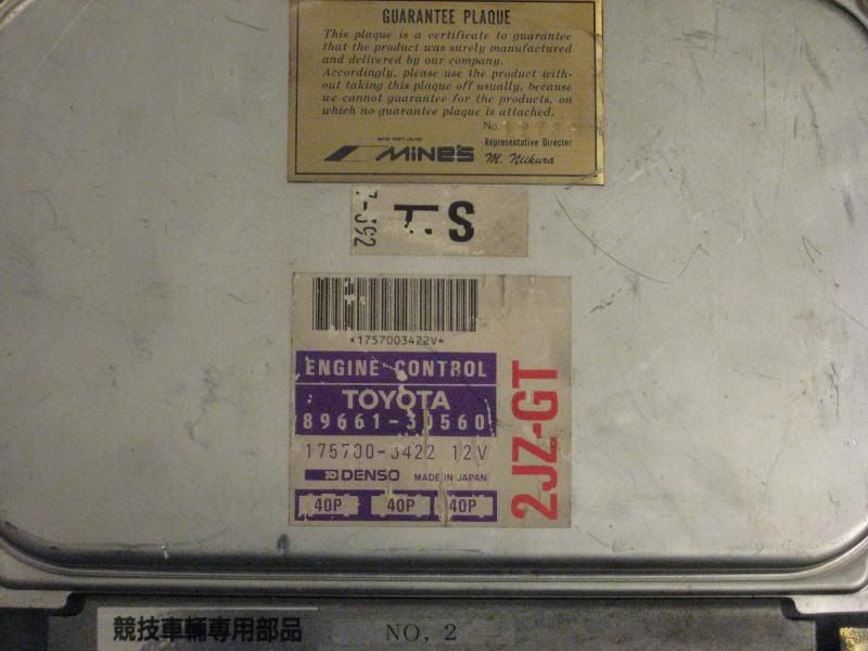

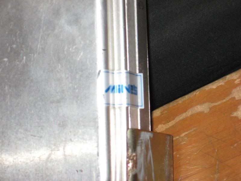

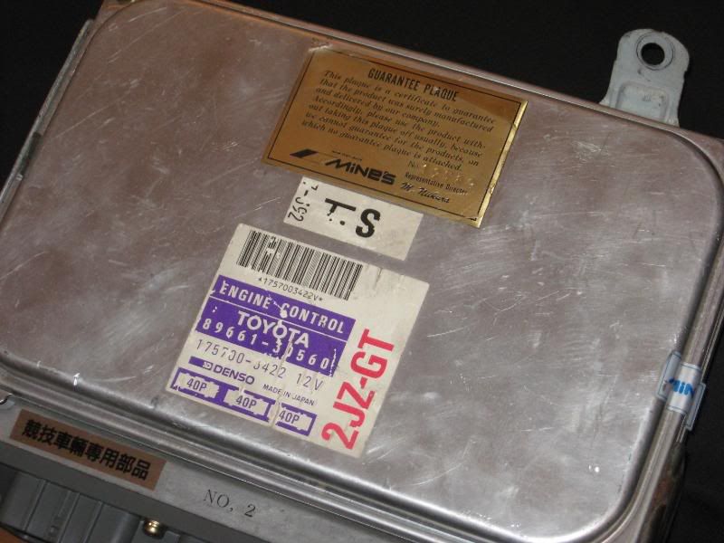

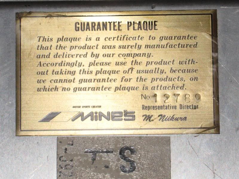

I never really got a chance to look at the ecu that came with my motor set untill a day or two. Mines website isnt really helpfull as to what kind of modifications the ecu could have. Do you think I should email them with the serial number on the plaque? Or is there someone that could tell me what it could have?

I'll be shocked if you get any response from them at all.
I tried the same thing a couple years back with the MINE'S ECU I'd found for my yellow plug 7M-GTE. I got absolutely zero response from every angle I could find.
Typically they have a raised rev limiter and boost cut/speed cut removed, and are tuned for an essentially stock motor with just FMIC/Exhaust sorts of mods.
Though occasionally they are custom tuned for a particular setup like a single turbo, big injectors, etc.
If it idles and runs normally on stock injectors (440cc's in the case of an Aristo 2JZ-GTE) chances are its a typical 'Boost Up' tune and you can modify the car from there with known piggybacks such as an SAFC or MAP-ECU, much like many MK4 owners have done running a VPC+GCC or VPC+SAFC setup on a USDM G-Force ECU. Though keep in mind that since the JDM 2JZ-GTE ECU is already MAP, a MAP-ECU only gives you additional tuning range outside of the typical range of the stock MAP sensor on the JDM 2JZ-GTE.
For what its worth I've seen plenty of cars making 500-600+ whp on a stock JDM ECU with bigger injectors and an SAFC. Ideal? no, but it works with careful tuning and a good AFPR.
Hope that helps
