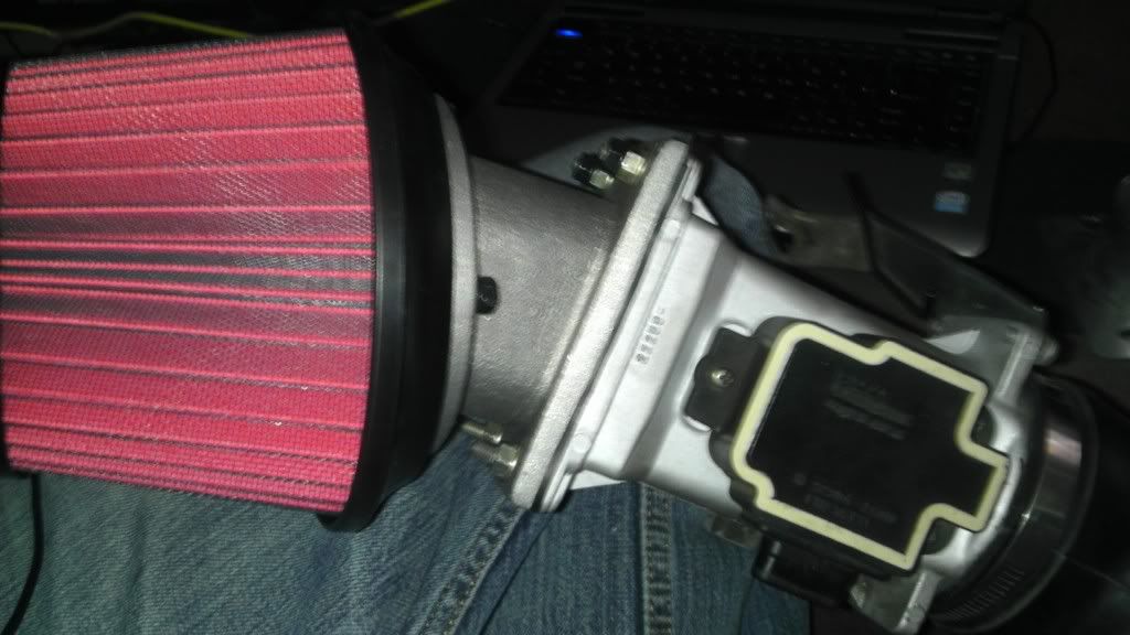

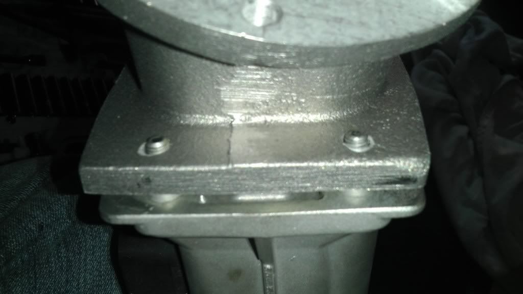

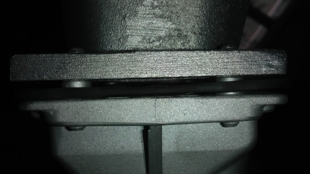

So i bought a apexi power intake from driftmotion
I have a Lexus AFM and well the pics speak for them self.
What would you do?
I have 2 ideas

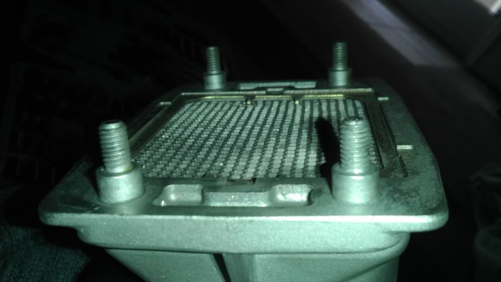

1st= Drill holes large enough in the adapter to fit around AFM studs
2nd= Switch studs with stock 7m AFM studs

I don't know why but the 2 Lexus AFM i have are like this the stud just has a stop in the way.
But it was easily switched with the studs from the stock GTE AFM
