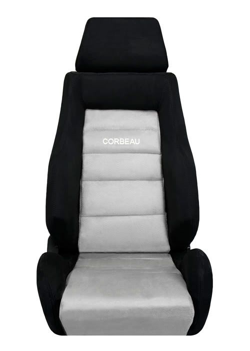

I'm looking at getting these seats...
They look almost identical to the TTR Recaros, and what I'm wondering is has anyone run race harnesses with them? And, if so how did you route them?

sorry can not see the picture. Blocked at work.

I get what you're saying. The car is due for a roll bar, 6 pt for now, which will be fine for what the car should run. No need for door bars yet. (Or should I?) The harness also will be mounted to the bar. Helmet is already taken care of.
I take it I shouldn't run harnesses with those seats, because there are no holes....Not really that big of a deal I suppose I had been wanting to get Kirkey's for the car anyway, guess I can get one and make it fit for the drivers side and just put it in when I have a race.
Just have to make the OEM seatbelt setup work with those Corbeau's, because I really, really want them.
