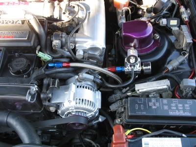

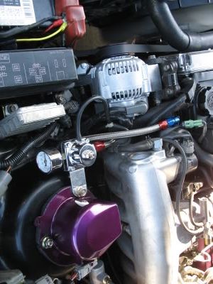

The only negative thing I could find is the slightly too large hose which runs from the fuel line to the regulator. It has to be bent a little, because you can't make it a 'perfect fit' as the engine has to be able to move a litte.
I considered that also (engine movement). This is how I routed mine with the loop in the braided hose. I used Earl's hose from Summit Racing. It was like $14 for a 3' long piece of -6AN. I also modified the ignitor bracket and flipped the ignitor on it's side to give my regulator a cleaner, less cramped look.
