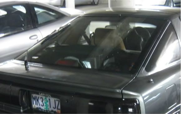

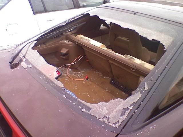

I did it all myself.
Sub system was stolen out of my hatch couple years back and i bought a spare hatch and just swapped the glass.
1. Removed molding carefully
2. Made a hole through the sealant of the windshield
3. Put Guitar string through and took two wood rods to make handles for wrapping the guitar string
4. Used a back n forth sawing motion to cut through the seal all the way around.
5. Clean off excess with razor blade.
6. Prep and place seal on current hatch.
7. Place windshield replace molding
8. VOILA!!!
BEFORE
AFTER
of course also after a repaint and tinted tails
