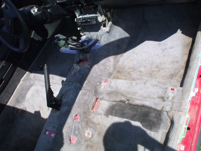

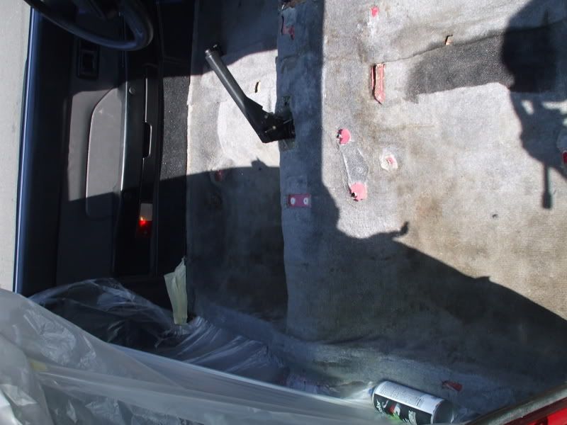

I painted the carpet in my 86.5. There are pics in my build thread of it if you feel like sifting through all the pages. The car had a light grey carpet originally but years of sun faded it to almost white in some spots plus some stains I could not scrub out. I used a paint that was for vinyl and fabric, I can't remember the brand. Anyway, I painted the carpet dark grey, even the carpet on the lower part of the door panels. Turned out very nice.

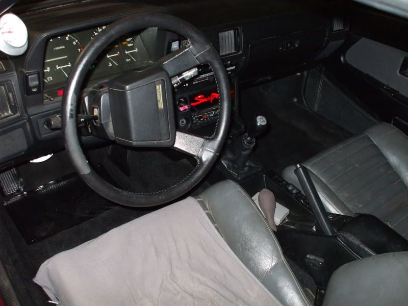

85celicasupra
spokane supra owner
Mar 9, 2008
256
spokane,wa
forums.celicasupra.com
i used the duplicolor stuff and did the carpet in my mk2
after
