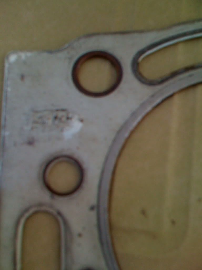

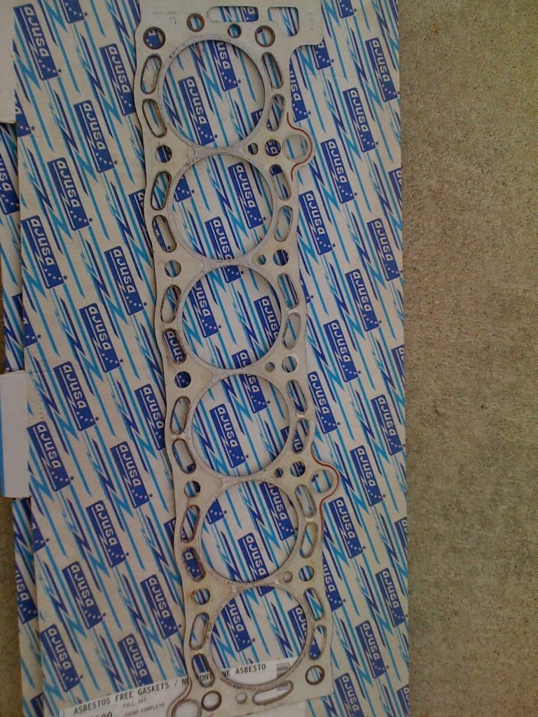

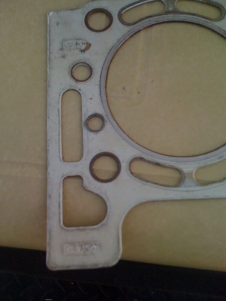

i used one for my 7mgte it was a metal hg with a silicone type coating on it i even reused it twice after building the bottom end 6 months after a bhg and i didn't resurface the block . i would say its one of the best ive used . i can post some picks of the used head gasket later if need.keep in mind this was used twice.

Yes I can confirm it is metal with a coating of some sort . Yea I normaly wouldn't use a oem headgasket twice . This one had the rubbery silicone type coating and just torqed it down to 78ftlbs instead of the 58 I did the first time .

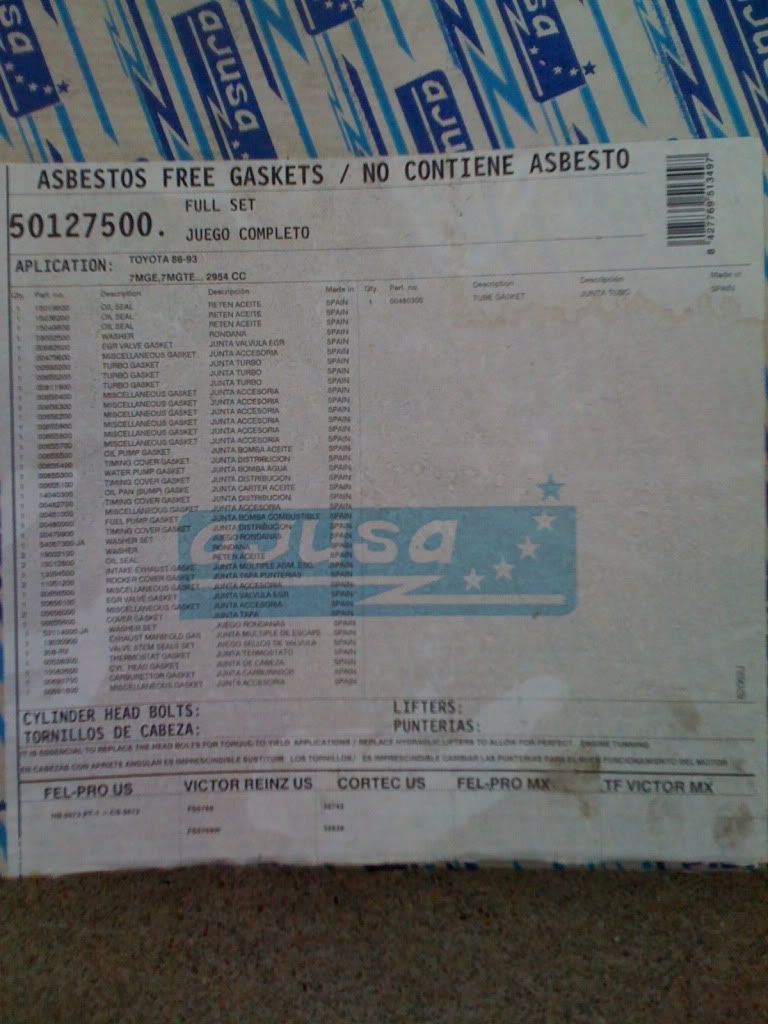

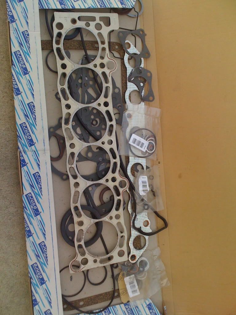

The majority of what people have been commenting on have been the head gaskets, but how are their other gaskets quality wise?

Yea you can thank the japs for that. the kit comes with every thing valve seals, new washers for the valve covers and new turbo gaskets . The quality is good they are just paper except for the exhaust gaskets . The header gasket is the double rivited type like the oem and they have all the gaskets for 7m-gte or 7m-ge.

actually the AJUSA Headgasket is NOT a pure MHG. Its a so called Metalmix gasket. On the outside its metal and on the inside composite.
I know a lot of people here that used the Ajusa gasket and are very happy with it. Its a lot stronger than the standart Toyota gasket, but also not as forgiving with marks on the head and block.
