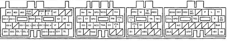

check the ecu pinout and make sure you are getting 12v to your IG signals. I think they are pin 12 I would have to check to make sure again.

Do you mean my igt signals? or the igsw? here is a pic, if you can point out which ones should have 12v I would apprecitate it, thanks for your help.
