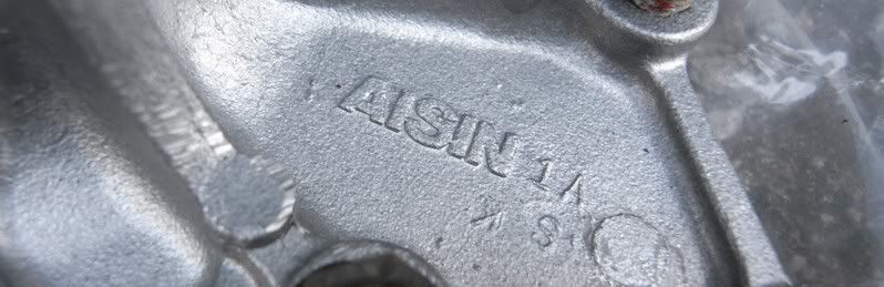

16100-49805-83
^^^ This part number WAS the AISIN original replacement pump WITH the STAMPED impeller in my case.:icon_razz
I will post some PICS later... (if I get a chance during work... otherwise tonight or over the weekend...)

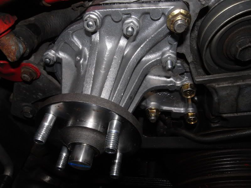

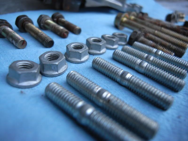

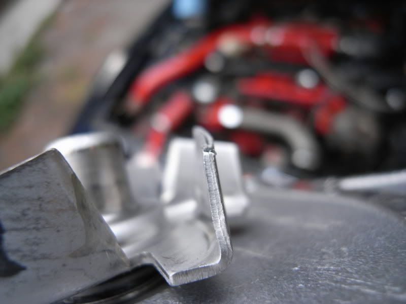

^^^ STAMPED impeller by AISIN... you can see some "die shear" on some fins even though it was probably "deburred" during production... so I took a Dremel tool to the sharp edges and "polished" them just enough to remove the rough spots and eliminate parasitic turbulence from the eddy swirls of coolant being manipulated by the blades...
...I also noted the TERRIBLE condition of some of the stock fasteners... so I converted to a STUD + NUT joint design (much better JOINT DESIGN) with parts I had laying around the garage... and used DACROMET coated nuts for better corrosion resistance. (The "Yellow Chromate" bolts are the "old style" hexavalent chromate containing MFZn2-C surface treatment... which is now all changed to TRIVALENT chromes by law... but no matter...)
Job complete! NO LEAKS!:biglaugh:
