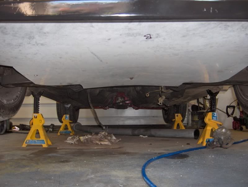

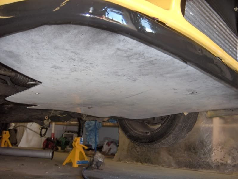

What I did was cut a card board template that extended from the front bumper and to the back of the front suabframe it attached to the front lip same as the factory under tray it Instead of aluminium I used Puckboard (think hockey rink siding) tough enough not to make any noise at speed but light and cheap Ill post some pics tomorrow
I'd like to know how this worked out for you. Also, what did it cost you to buy and work with this "Puckboard" stuff?

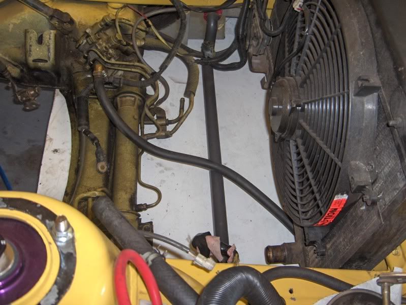

here is my mod to make all air go threw the radiator. Some alu-pieces.
Now that looks functional! I'd be compelled to get an extra fresh air duct into the radiator from above the intercooler, and perhaps create a duct from the bumper to the intercooler as well, but that looks great!

Thanks! Its very functional. 99.% of the air my electric fans are sucking in, is going thru the intercooler. I also can recommend a tight construction around the fans so no air is sucked in from the side. Ofcourse I have no scientific proof of the efficiency here .. but you can feel the draft even when you hold your hand 10-15cm from ic.

Sorry had no time to load pics today puck board costs 40$ IIRC it can be cut with a pnematic shear (thats what I used) tins snips work as well I had the factor under cover when I lost mine I noticed a night and day difference at speed I used 80% of the factory mounting points, Ive had my car over 150mph and no noise comes from my under tray

Heres some pics of what I made using puck board light weight (sorta) very tough and cheap
The only thing I have to modify is the center mounting hole Im going to heat it up and depress so it does not warp the rest of the cover
