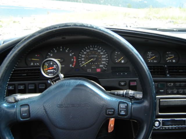

I have my boost gauge mounted on my steering column.

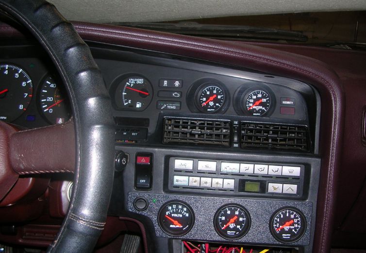

i'll be custom mounting my gauges in my gauge cluster, replacing the existing gauges, like jimi did. all the "important" gauges, such as oil pressure, water temp, boost, and wideband will be mounted in an easily visible spot. the stuff such as volt meter, oil temperature (ive got a 180* t-stat) and other stuff will be mounted where the climate control unit is.
the climate control unit will be relocated in the passenger side dash, because i dont constantly adjust the temperature. the debut will be this spring/summer. i cant wait!

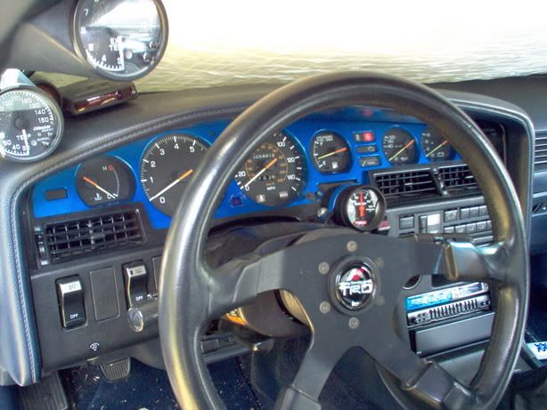

jimi, are those 52 or 60mm gauges? i knew the stock gauges are 60mm, but it looks like jimi's got 52's in there, which is what i inteded to do...

i couldnt find the one pic i was looking for but they look almost the same but they were hung in front instead of inside like yours but i think yours look better good job ill prob. do the same on my new supra

52mm, some trimming is needed on the end "hole", it is smaller than the others.

the cup was like,...$15 @ pepboys, and it is mounted w/ 2 screws, straight to the plastic. just test fit it w/ the gauge in it, mark it and use 2 "short" self tapping screws. i drilled pilot holes first, slightly smaller than the screws, so i wouldn`t crack the plastic. if you use screws that are too long, you might hit the combo switch!
