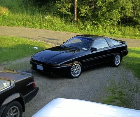

I guess a little history wouldn’t hurt. I bought my first Supra, an 88 Turbo, back in ’98 when I was just a 20 yr old broke college kid. The car didn’t run when I got it – had a bad turbo, bad CPS, blown headgasket, and some creative engineering work under the hood. Well a solid week of working on it along with some healthy credit card debt and I was rolling.
My mods consisted of a manual boost controller, gutted cats, K&N fipk, springs/struts/swaybars/rims. Just enough to make a young guy drive his car so hard that things break. Here’s a pic of the ol’ beast in it’s heyday:

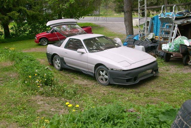

Here’s what I found:

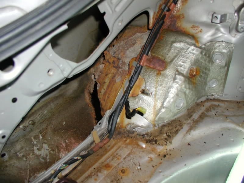

An ’87 Turbo that runs and had a brand-new bodykit with it. Again, on impulse (and since it was dirt cheap and only 45 minutes away) I scooped it up without really checking it out – solid body my ass, dude did a good job hiding some of the not-so-solid parts of the body (especially the driver’s side rear wheel well):
Hopefully that’s the worst of it, no worries tho, I’ve got a friend who’s a professional bodyman at the Toyota dealership and will be helping out in exchange for beer.

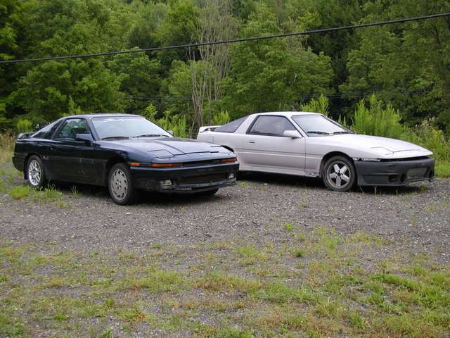

Here’s how they were last week, no engine in the blue ‘parts car’ at that point and the bumper just set on the grey car:

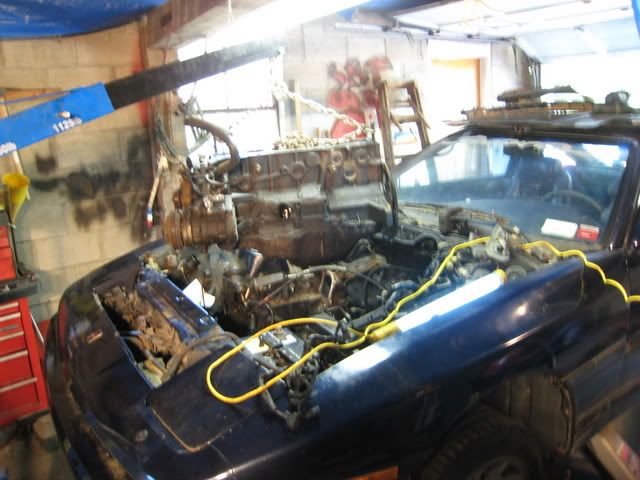

First step was removing the engine/tranny from the parts car, on the day I decided to do it I didn’t have an engine hoist handy yet but I really wanted to get started so I pulled the head first and the rest later on… That sucked some serious ass, I won’t be doing it that way again:

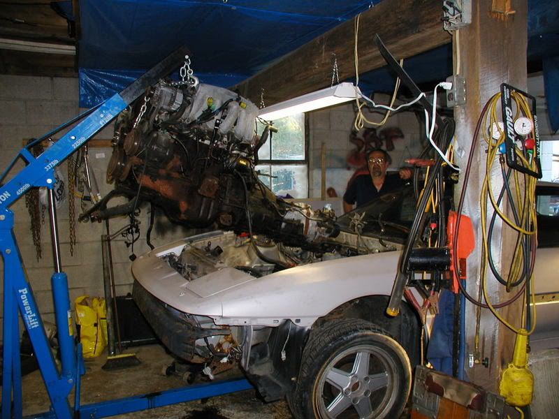

Then impatience took over, I wanted to start work on the car I’ll actually be driving so now I’ll be pulling a lot of stuff out of the ol’ supra outside instead of the comfy garage. But hey, it’s progress, pulling an engine this way is way easier and way way way quicker:
That’s my dad (northeast US’s “Toyota guy”) looking on, probably thinking “Man, my 30 yr old ‘kid’ makes a lot of work for me, not to mention makes me really nervous! And wtf, I thought we were done with Supras years ago…”

The ones in the first pic of the blue Supe? It's been a long time but I think they were called Kosei Seneka 8's or somethin like that. I got them in a group buy thru SOGI 8 or 9 years ago...
