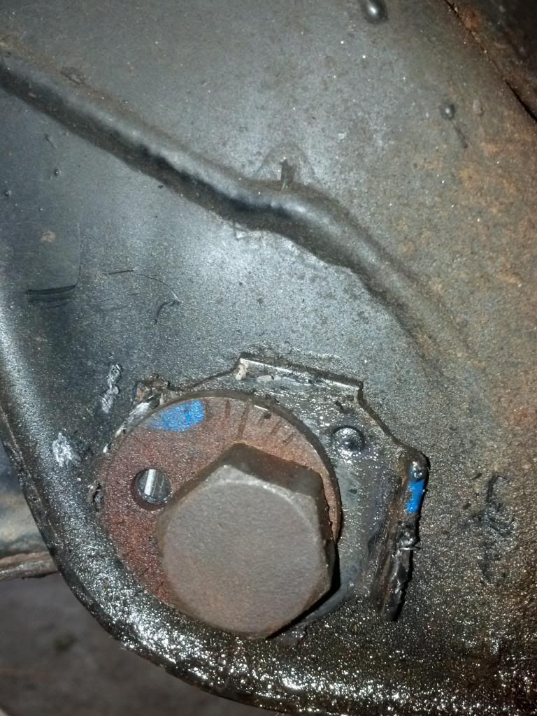

So I have just got done replacing all of the front and rear bushings with Energy suspension parts and added eibach springs to my tokico struts. needless to say but i have alot of time and money tied up in this car ive had for 4 years now. so i had marked the position of the camber bolts on all arms that have them. and returned them to this position.everything was spotless and lubricated as needed. well the shop bent the tabs the cam bolts rotate against, then tried welding the tabs back and set fire to the es bushing, then stripped the bolt. i then made a trip to a junkyard to replace the broke bolt and then they had kinda fixed the tabs for cam, but there still a little bent. anyways $80 and 8 hours later i have 3/8 toe in on front,1/8 toe on rear,camber is unknown. oh and the steering wheel is crooked too. they thought it drove good for a 26year old car. and this was the recommended shop in my town by the old folks. SMH its been a horrible day.

Gonna take it to the better business bureau. But in the mean time id like to fix it right and get it back on the road. I tried to fix the tabs but it may come down to cutting them and adding 1/4 square stock in place and I'm tempted to buy all new camber bolts. :/ I can't see why eibachs and polyurethane bushings would be so hard to align? Is there just not enough adjustment? All the camber bolts are turned 90° from where it sat on stock springs and bushings.

When you do this, the alignment angles are now wrong. There is only so much compensation from the eccentric bolts. Using a torch to heat up rusted/frozen bolts is common practice in areas that have such issues.

Bolts were spotless. Looked close to new. Also they didn't release the mats that the tires sit on so your not forcing the tires to flex on the machine. I'll try Toyota or this other shop that has done good work for my friend. Hope the tabs are strong enough for one more alignment :/

well i went to toyota and asked for the master mechanic. he sayed what he would do is go to this old dude named seymore out in BFE and have him sort it out. he highly recommended this old guy. the reason why they cant fix it is because he feels the only way to truely fix it is to weld the tab. they dont have a welder though. so i left the car at this old dudes place. he seemed very meticulus on how he worked. everything was clean and organized. his son does most of the work now 3rd generation on the busniess from what he says. there alighnment machine is something that looks old as dirt but they say that the best way is the old way. anyways i explained that the tabs where bent and would need some weld or support behind them and that the bushings are high dollar and that i would pay them for the time and effort to drop the control arms while welding the tabs up. Really this alignment should have been simple. but that just proves that you cant find good mechanics in my town. hope this turns out better. worst case scenerio i buy new bushings and buy a welder and add 1/4 square stock and some camber bolts and drive it to a well know person.
