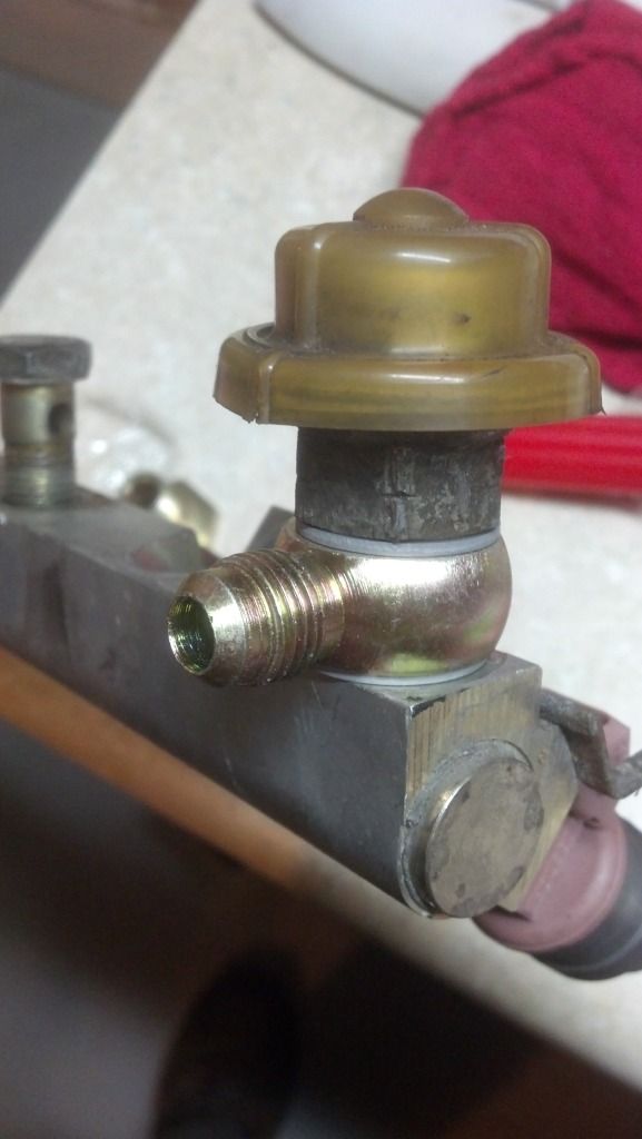

supraguy@aol's fitting solution

Feed on the rail (fpd) is M14x1.5 return(fpr) is M12x1.25 I haven't figured out the threads for an an adapter off the stock supply line like driftmotion sells yet so if anyone knows....
