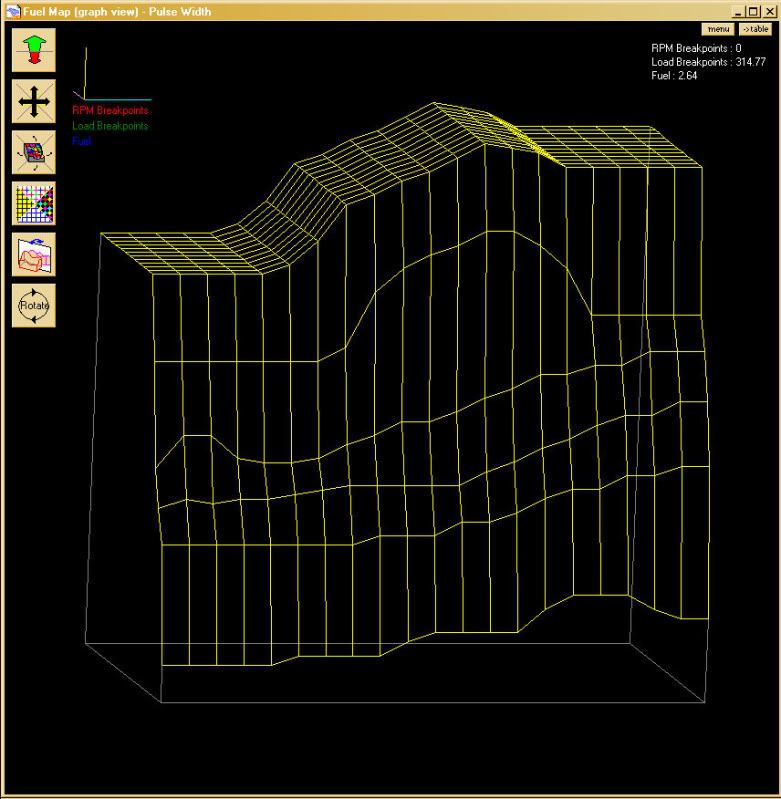

Well, I will keep tinkering with the phasing, but so far I cant get it to run well with anything but the 000000. It looks like its going to require quite a bit of change in my whole fuel map to fix the phasing properly. I have lost faith in the tuner I used, because he didn't seem to change much. He sort of got me started, which I feel isn't what I paid for.
Here is my air intake temp/fuel correction table and my main fuel map. I actually have made quite a few changes to it already for the better because it was quite a bit more jagged and not smooth (fuel map) I dont even th ink the air intake temp/fuel correction was touched
