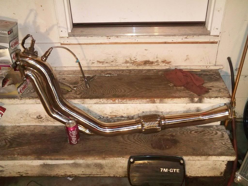

I ran a divorced downpipe and it was fine, but I had issues with boost spiking too high. I swapped out a bellmouth downpipe and it seems a bit better, as well as the bellmouth fit slightly better than the DDP. Both were Ebay specials, and based off of that I would suggest you run this one. Its cheaper than the DDP I ran and functions just fine. Combine it with the catback of your choice and BAM! You've got yourself a nice exhaust system!
Picture of my DDP:

You still want it divorced, you just want it recirculated, not dumping to atmosphere. If you went divorced you'd want one exactly like how toyotanos linked in the picture (only hopefully fitting better). The BIC ones are good for fitment, I have no idea on others though as that's all I've worked with. The issue you typically run in to is the metal tab that separates the waste gate from turbo exhaust doesn't fit properly. If it's too big you can't bolt it up flush and you end up with an exhaust leak there or if it's too small you get leakage past that tab and start to negate the advantages of the divorced downpipe (and if it dumps to atmposphere it's even louder under regular vacuum conditions).
