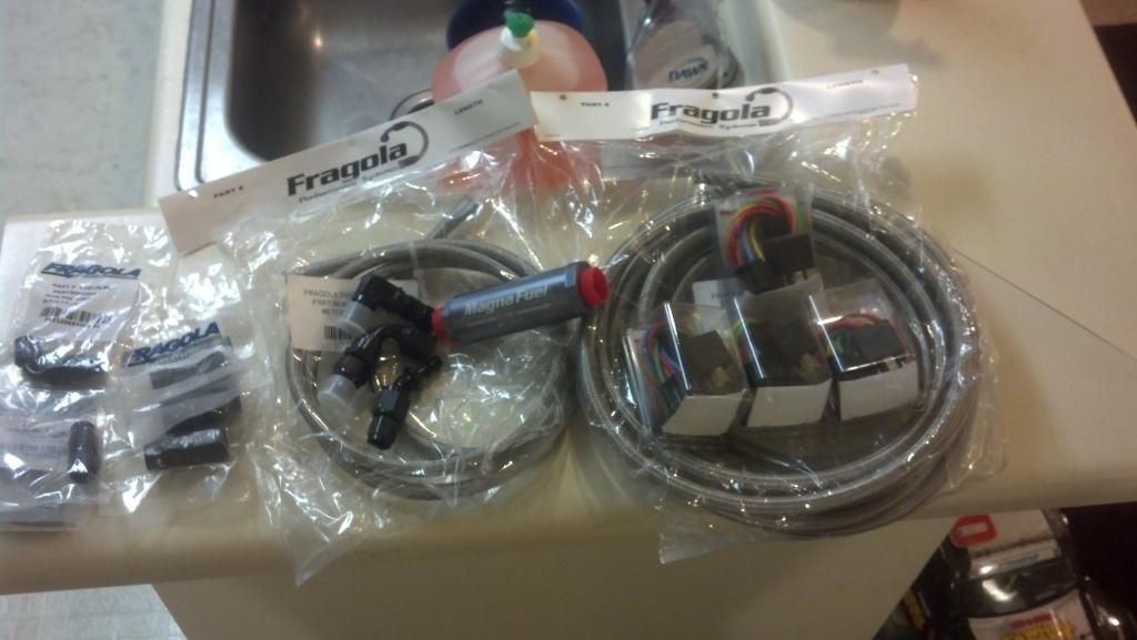

Single ~340lph pump the factory return will suffice, but if you go dual you'll need to either run new hose or double up. I used the factory vent line as my second return line- it's actually just as big as the return line if you cut the crimped/reduced ends off.
