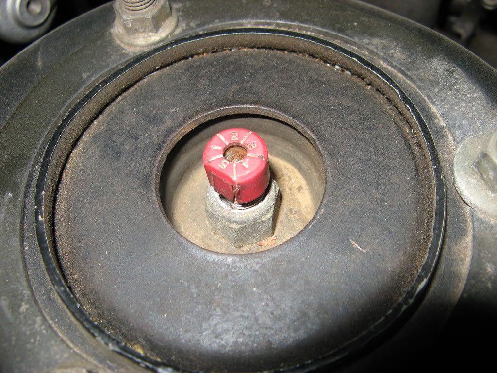

Guys I have a turbo A and I am looking to stiffen up my ride, I want to know how the hell to adjust it, and also how to read it once I have adjusted. Also how do I get my gauge cluster out?!

It has a red top on either side of the top of the front suspension with the markings 1-5 and a tiny semicircle knob inside, the guy i bought the car of said he changed it to the least stiffest setting because it was too bumpy for him (he was in his 50's). I have been told by a few other turboA owners that the stiffness levels are adjustable via the top of the shock that is showing in my engine bay.

probably konis, but the only ones ive seen for a few years now is the infinitely adjustable ones, not ones with five settings. the semicircle sounds about the same though.

That looks like my TRD springs that I had on my car. and they came off a TTR JZA70.
You turn to clockwise ( higher number ) to stiffen and anti clockwise to soften. These are not made by Bilsteins. If you look at the bottom of the chock, they are Tokicos, 5 way adjustable rebranded for TRD.
You turn the inside and the red cap is to show what number its at. There should be a mark.
