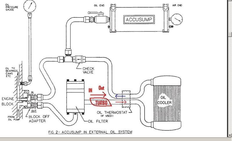

Has anyone (more curious about na-t'ers) ever setup their Accusump with an oil cooler like so?:
I like the idea of cooling the oil before it enters the oil pan, but I'm curious if anyone has their setup like this and how well it worked.

IJ.;1132064 said:
It doesn't "enter the pan", the pic is of a full flow system and NOT the stock bypass system.
Mine runs exactly as pictured minus the manual valve.
If I'm understanding correctly, you're following the above picture WITHOUT my edited turbo placement correct? So, the turbo cooler is simply sandwiched within the stock oil filter path right?

There's no point to your "mod"...the stock turbo feed port is in the channel that feeds the bearing and squirters. It is post filter (and cooler) as well, when the stock cooler system is switched to a full flow remote set up. Don't fix something that's not broke.

You can also use an electric vs a manual valve on the Accusump that actuates (via a relay) when the ignition is on. This will allow you to use it as a pre-oiler...turn ignition on, wait 5-10 sec (oil is pushed into the engine), and start. No more "dry start" ;)
This is the main reason I'm getting it, thanks everyone for the explanations! Supramania FTW! :naughty:
