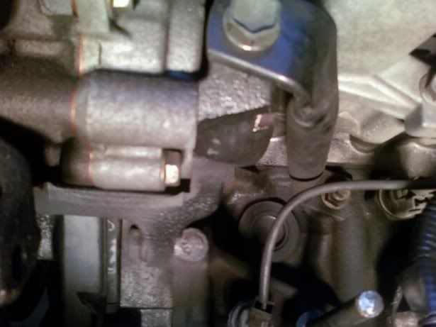

nctexan
Nov 30, 2009
268
Houston
I've ground a bunch off of the power steering pump bracket. I still have the motor out of the car. I measured the height of the SHCS that go into the fittings on the coolant lines (which are in the engine bay, I don't see a way of removing the fittings or hoses from the bay without destroying them) that go onto the head, then screwed the SHCS into the head by themselves, and mounted the compressor back on the motor. The screws will clear the bracket as I've ground it, but there is no way in hell if I mount the compressor on the motor, drop the motor in, and manage to wedge the fittings from the lines into their spots on the head, that I will have room to put the SHCS in. How do you guys get around this?
I've attached the pic of where I've ground the power steering pump bracket. Is this enough? It is already eating into one of the mounting stud bores for the power steering pump.
