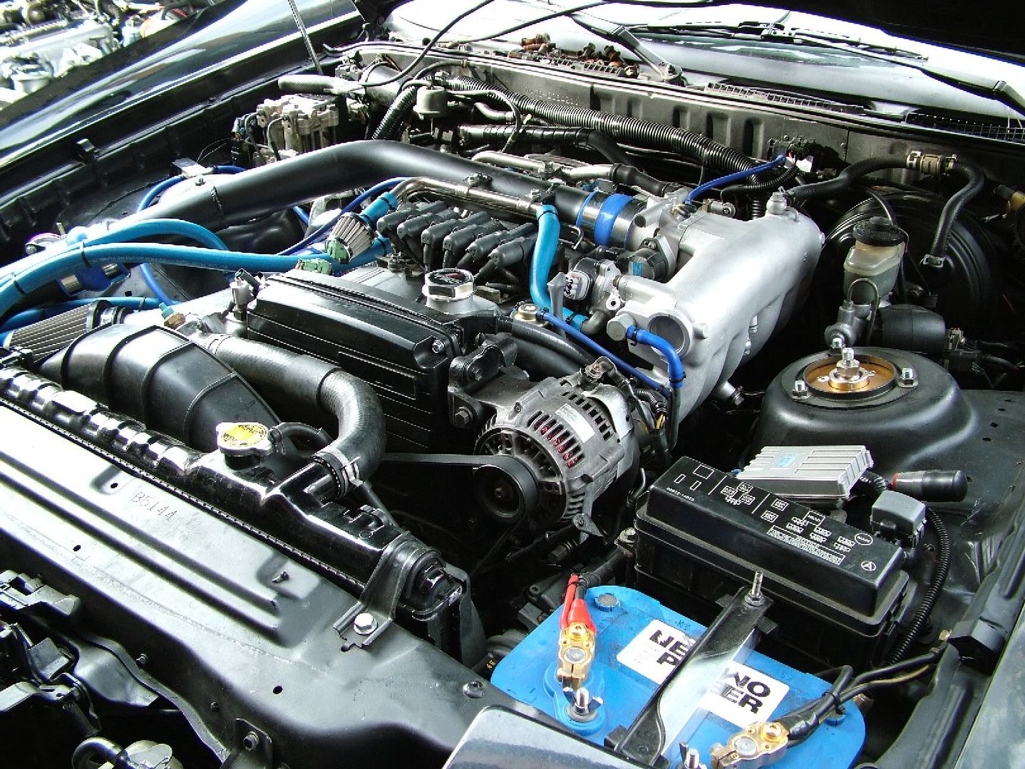

Thanks! The manifold clears the stock oil filter housing fine but I moved the filter because I am also installing a bigger oil cooler, and a remote filter that will not make me use every cuss word in the book while changing my oil! I also am using a remote oil thermostat so the cooler is bypassed when the engine oil is cold. I am installing a oil catch can in the passenger fender tomorrow.
Here's where it's at right now:

It's Alive! We put some time into it this week and got it done today. It fired right up with all the basic settings on the maft pro. I have a code for egr but I expected that. I only drove it a little today so I would be sure it would make it to the big TORC car show in Long Beach tomorrow. I am really happy how everything has turned out. I ended up making my own downpipe and modifying the dump tube that came with my wastegate to clear the downpipe. Here are some pics in no particular order, it's late and I have to be up at 7am to go to the show. Ginish is actually buffing my car in the garage right now and it's 12:30 pm lol. Jose really helped me getting it done for the show so thanks Jose! We are putting an upgraded intercooler in his car but we ran out of time this week.
