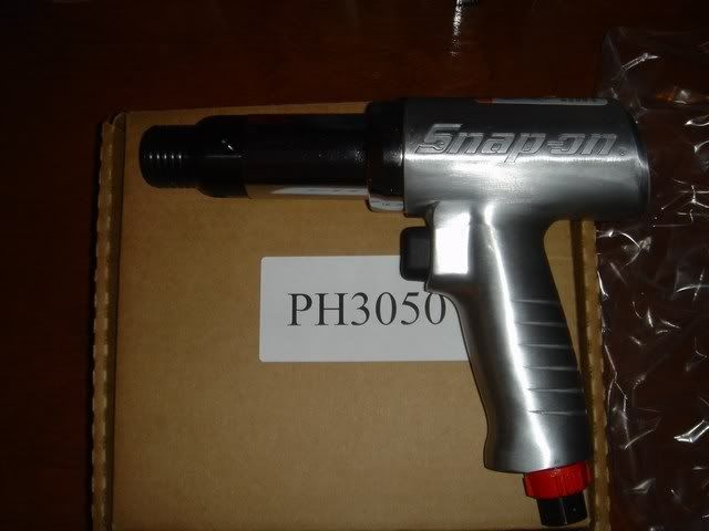

Axle puller should get the job done, as would a nice, big air hammer.
This:
or this
That's my work tool, haven't met an axle that stayed put under its 'persuasion'

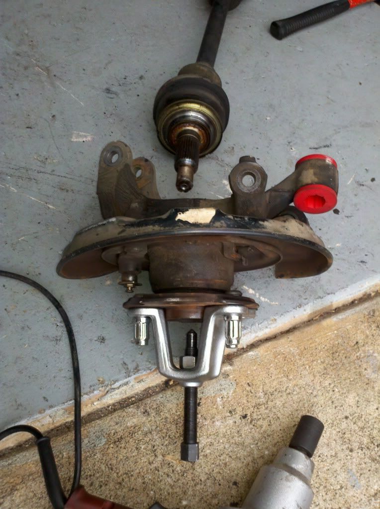

I have the above axle puller.
There is no way to connect it. The center point would go against the axle hub, but what do you bolt it to?

You use the lug studs and lugnuts to hold the frame to the hub, lubricate the center threads (they will get very hot) and use a long ratchet to thread your way to victory(impact wrench helps greatly for that part)

I *thought* I had that attachment, but I was thinking of my slide hammer attatchment, which isn't 'domed', and wouldn't work.
Went to Autozone, they rented me one for $25, and had the damned thing out on the first try.
Just did the other side, came off like butter. Well, at least I'll get my core deposit on ONE of these two axles...
