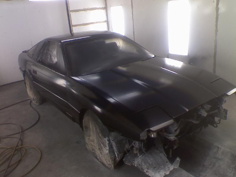

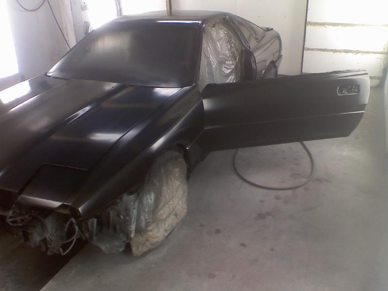

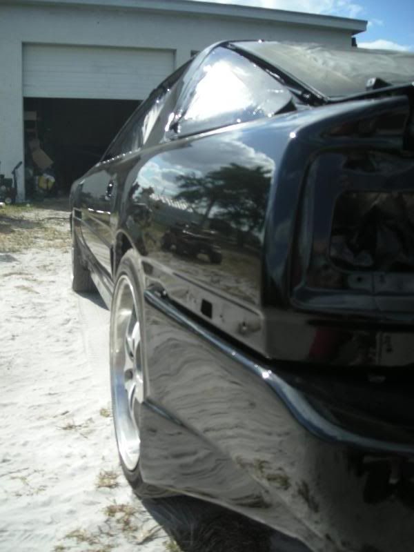

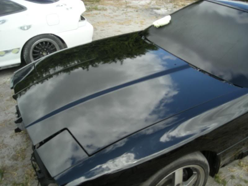

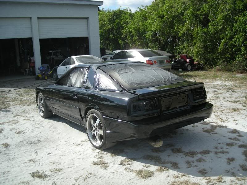

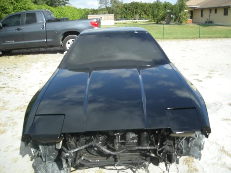

pics!
we got the 1st coat of base laid today but we ran out on the 2nd! we used 2 gallons!
tomorrow or wed. the rest of the base will go on along with the clear.
i'm VERY happy with this paint! it looks almost like there is clear on it! the pictures don't do it justice.

Looks good so far.Make sure if it sits more than 24 hours that you lightly scuff/sand before the rest of the base goes on.2 gallons seems like an awful lot for 1 coat,that's why it has such a shine too,it was obviously sprayed real wet.
