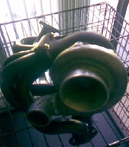

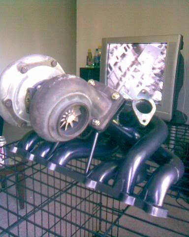

here's 2 pics of my 60-1 on Drewgo's mani. had the 2 bolt flange welded on instead of the Tial 44 vband flange.
will be going in the car this weekend along with my A/C system being finished. can't wait!!!!

hahaha indeed
i had a greddy 1J T4 manifold and imho this one is higher quality. the welds are nice, the ceramic coating from drew is AWESOEME, and where all the runners collect before the turbo is ported out and VERY smooth.
money well spent!!!

hahahaha nah wife wont let me bring it to bed :(
its was told by previous owner just like he was told when he bought it that its a Garrett T04S 60-1
but im beginning to think its a master power or something. the turbine housing looks odd.

Exhaust housing is def. not a master power.. IDK what it is. Nor is the compressor housing.. the center section could be, but it could just as easily be a garrett. Nice setup! We need more pics :)

i will try to get more pics of it. i'll post em tomorrow if i can. my comp. at home sux bawls so its hard to upload anything
its like they tried to polish it but gave up lol
Ninja Edit: there's a tag on the comp housing that looks like it says AE0602 or AF0602 or something to that effect

it is a garrett turbo. i was told so by the guy who bought it and put it on "conrad at c&n performance. will be a great turbo for the street. spool is almost instant. u won't miss your twins spool too much. good luck.

There is no such thing as Garrett Turbo here in South Florida...lol
Justin,I had the same turbo from Conrad ,it got the job done.
If something goes wrong just change the cartridge to a master power.
Inexpensive and reliable.
Also just an fyi. Use a -3 oil feed not a -4. 1j's have high pressure oil and will eventually make the rear seal on the Journal turbo leak then you'll get white smoke.

the blackplate looks weird.. not like any garret i've seen, either way its a good turbo... no play and daneyan used it fine..
