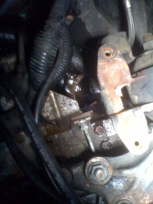

Well, once the engine was broken in n/a I returned it to my roommate who three days later, blew the diff and drivers side axle in one shot. A buzz kill at best.
So it began again. This time with a '94 trans with higher gearing perfect for boost as the '91 will do a lot of spinning as it is.

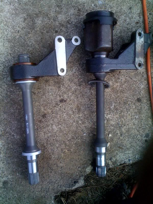

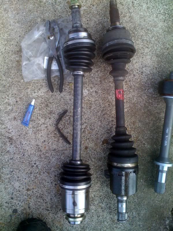

Starting with the kia rs axles and comparison

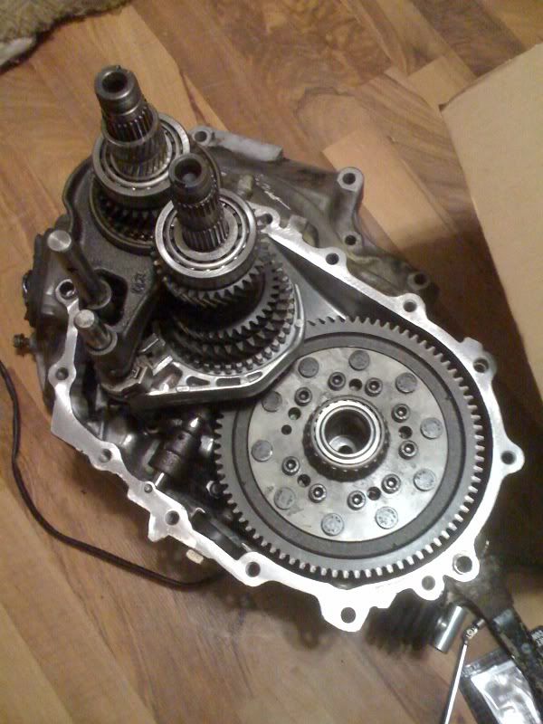

And trans with quaife lsd
