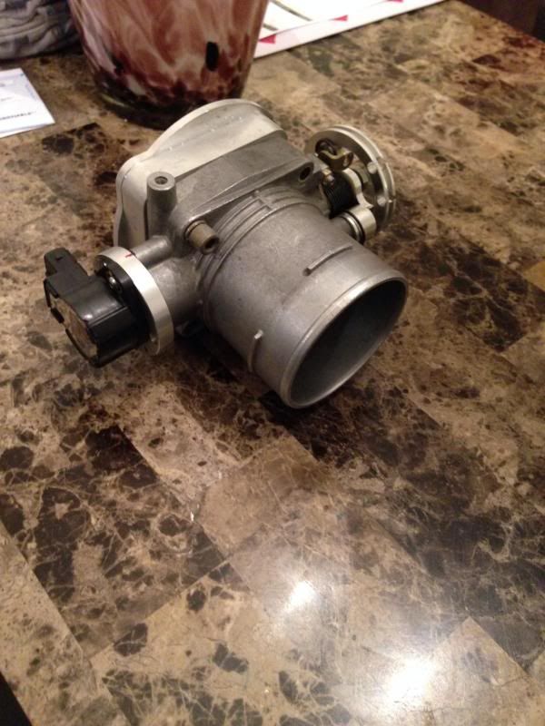

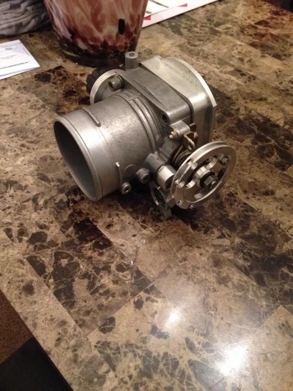

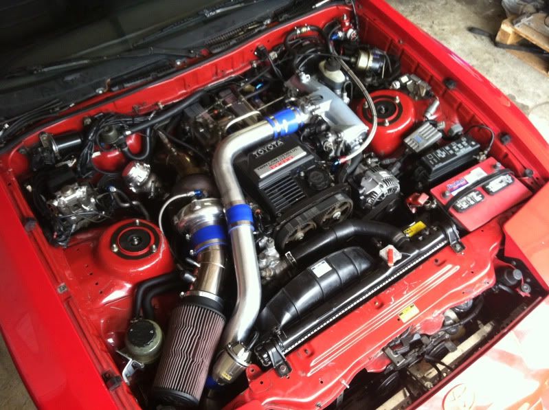

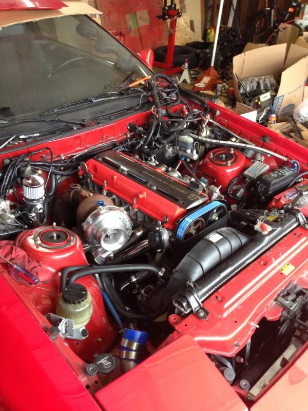

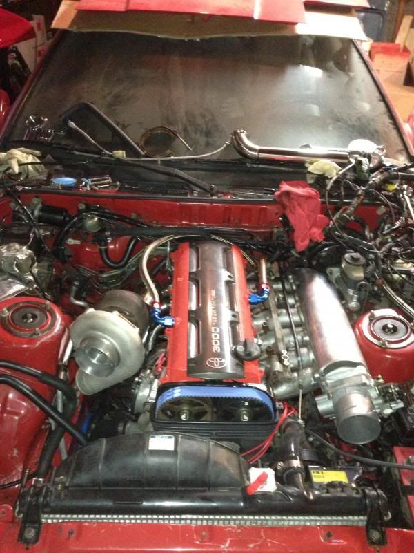

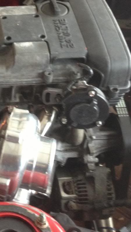

mk3turbo;2004461 said:
Did a little modification to the q45 throttle body. The throttle body cable bracket was hitting the power steering pump so i modified it like this to clear it. This is a very tight fit. Also the tps has to be custom fit.
Any insight you can give me about the throttle body bracket? I am running into the same issue where it is hitting the power steering
Btw. Nice build. I'm almost done with mines, just running into small little issues to address.
Thanks
The factory q45 bracket was hitting the power steering and lower runner so i use an aftermarket tb wheel bracket.
Jtsan
Jul 10, 2011
Brockton MA
So you just removed all the old brackets and the new one just bolted on? Did you have to modify anything? Also if you remember where you got it could you provide a link?
That wheel tb bracket is from an ebay 90mm tb i got laying around. There is a few things i had to modified, drilling and cutting to make it work.

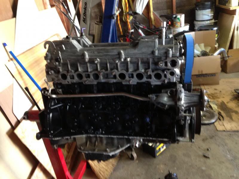

Little update on this build…….2023
I havnt update this build in a long time, the mark 3 have been through some changes in the missing years. I can now say that Ive finish this build. My goal was 500whp to begin with but ended making 833whp and 794tq on e85 @ 32psi
550whp on 93 pump gas @20psi. Dont know how the act extreme 6puck clutch is still holding. Car is very fun and exciting to drive, cruise around and it has cold AC. I enjoyed this car every moment im out for a rip or just cruising around. Its a fun weekend warrior car other then that it sits 90% of the time in the garage. Life is good, thanks for looking.
New mods: built 2jzge, manley piston 9:0 cr with upgraded wrist pin, manley tuff H rods, 2jzgte hg, arp head studs, arp main studs, acl bearings, stock ge cams, bc single spring and retainer, bc cam gears, s366sx with billet blade, driftmotion 3in exhaust, driftmotion flywheel, treadstone TR1245 1000hp intercooler, q45 tb, one piece driveshaft, dm light flywheel, act extreme heavy duty 6 puck clutch kit, fic 1220cc injectors, dual walbro 450 fp, 8an feed, 6an return, stock 2jzge fuel rail with dual feed, Sx fuel pressure regulator, yaris coil, custom ross racing machine intake manifold, flex fuel sensor, ecu master black, sequoia alternator, tial 50mm bov, tial 44mm wg, Twin scroll turbo manifold, fluidampr harmonic balancer, billet tensioner, braille 15lbs battery, big 3 upgrade, Mercedes benz bbk, evo rear brakes, ecu master black, gates timing belt, 98 mk4 supra steering wheel, wideband, flex fuel, pressure sensors, oil catch can, rework trd strut brace, 2 hole shine auto lip, jdm tail lights, euro corner lights, double din 7in screen head unit with back up camera and dash cam, toyo proxes 315x35x18 drag tires in rear, 245x40x18 front, 18in chrome cobra wheels, push start button mod, aem trim pot switch, probably more im
