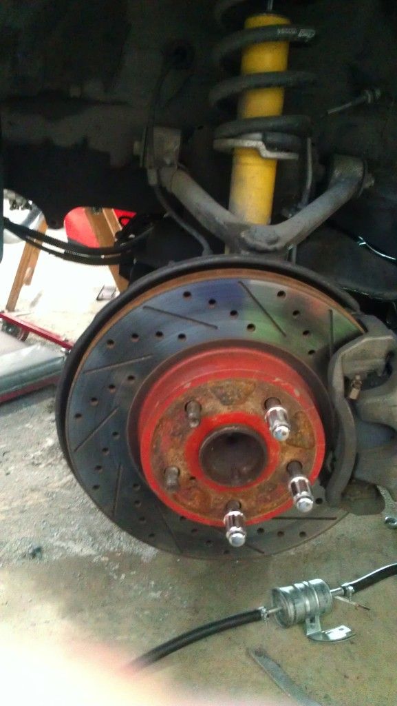

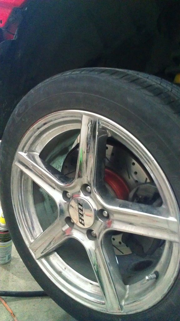

Also, there's a few upgrades done to the suspension on the 89. It has cross drilled and slotted rotors, stainless steel brake lines, what looks like EBC bluestuff brake pads, bilstein shocks, and eibach springs. Easily 500 dollars right there....

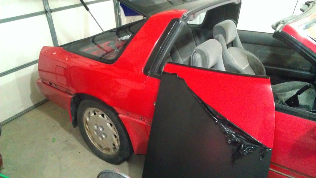

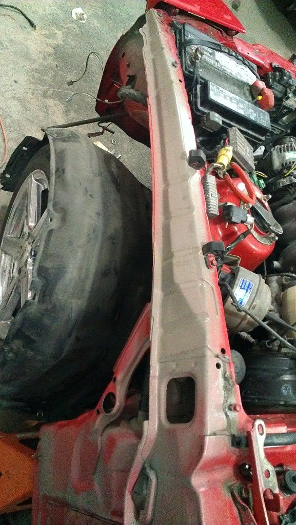

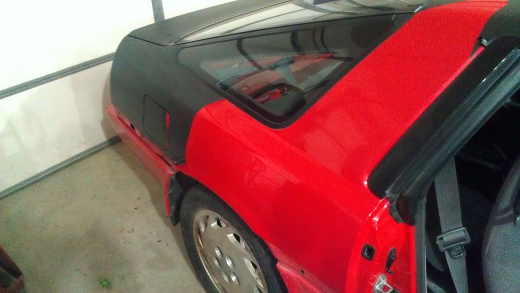

With the car home, I noticed that the black paint on the black half was NOT primer, and was actually Plasti-Dip. Peeling this stuff off was so easy and actually kind of fun.

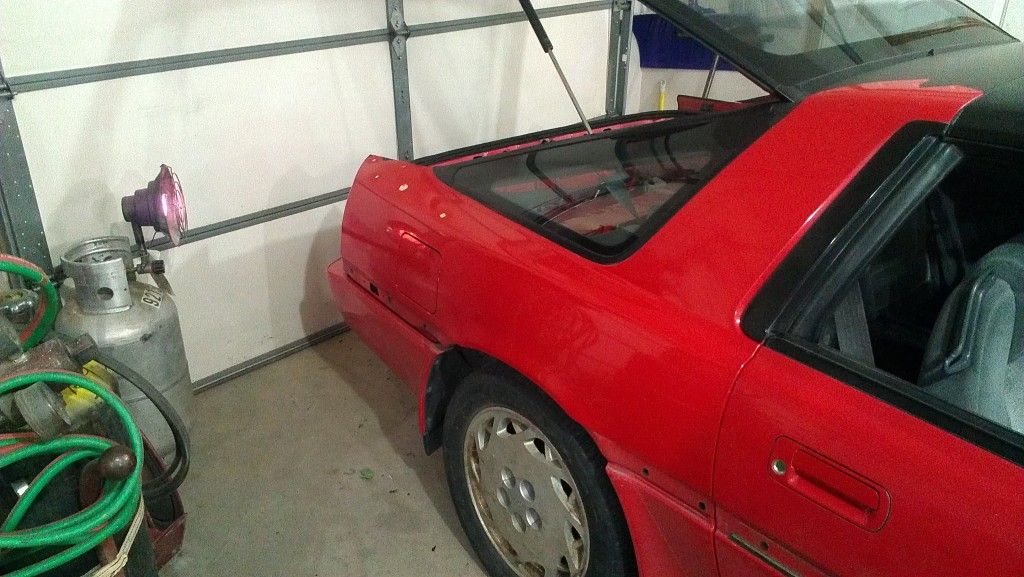

So with the passenger side stripped of all impostering plasti-dip, I decided to attack the driver side. The passenger side paint was PERFECT, but the driver side is not so good. The PO decided to start sanding down the paint for new paint.. Or something.. But irregardless of the reasoning, the driver side rear quarter panel needs paint. No big deal, a couple hundred bucks at a family friends body shop and I should be on my way.

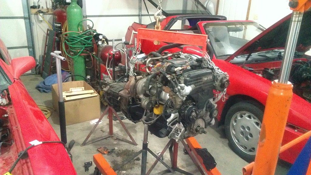

With that done, I decided to tackle pulling the engine out of "Rusty". Within a few days, here's where it's at.

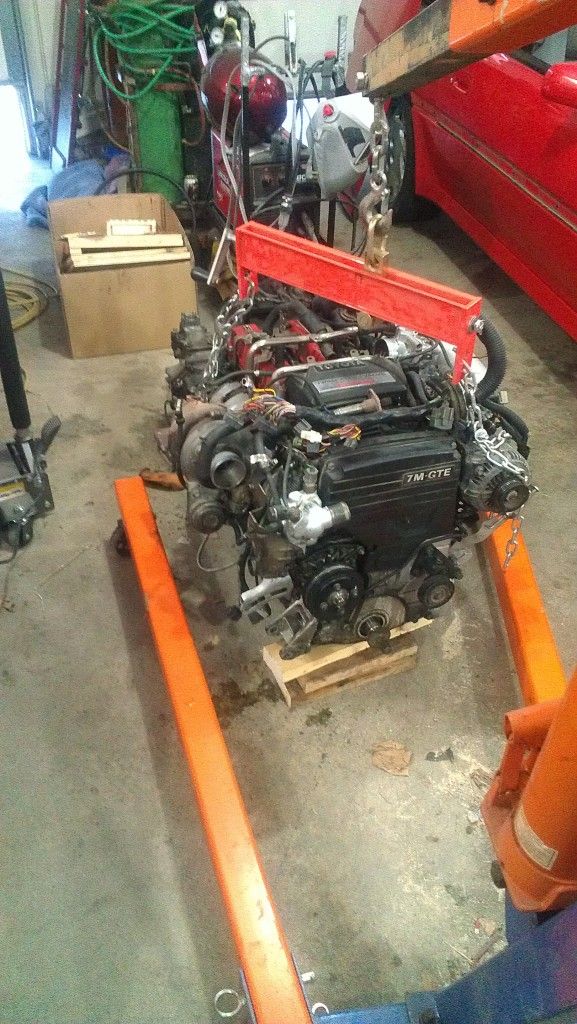

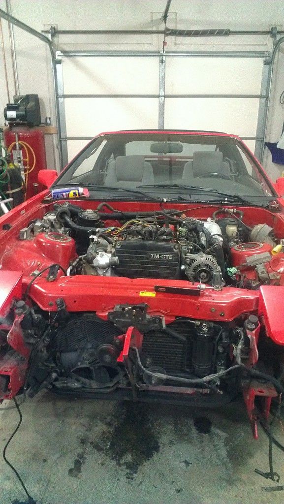

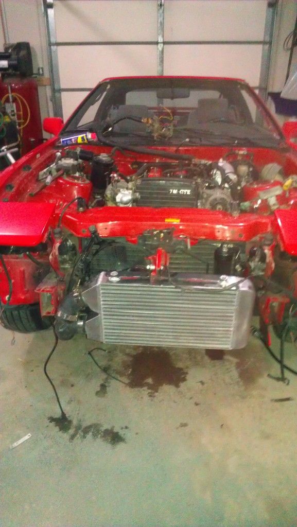

Now we're getting up to date. Just Saturday I dropped the engine into the new car...

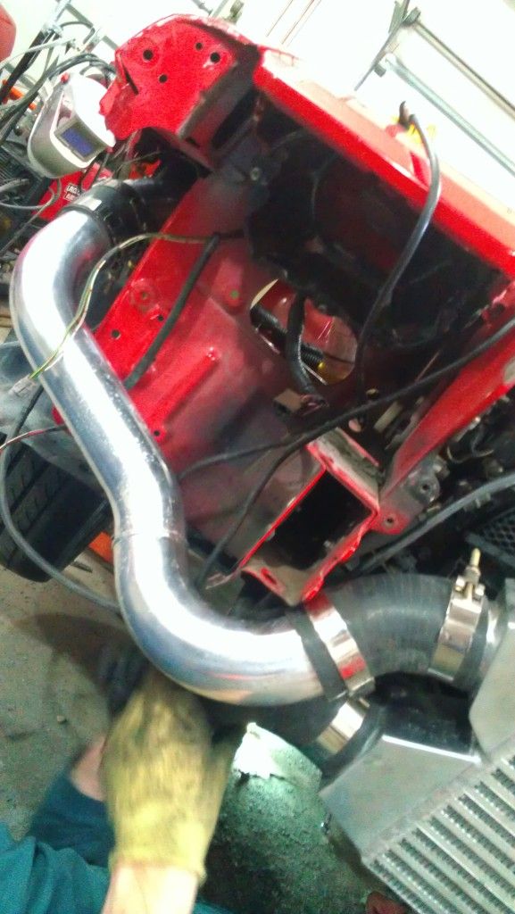

Now I remounted my DM new style intercooler

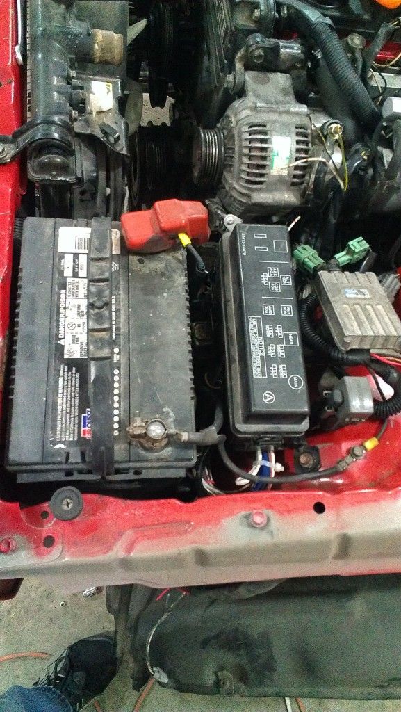

And started hooking up all the accessories. With the harness repaired, I decided to tackle the Alternator wiring.

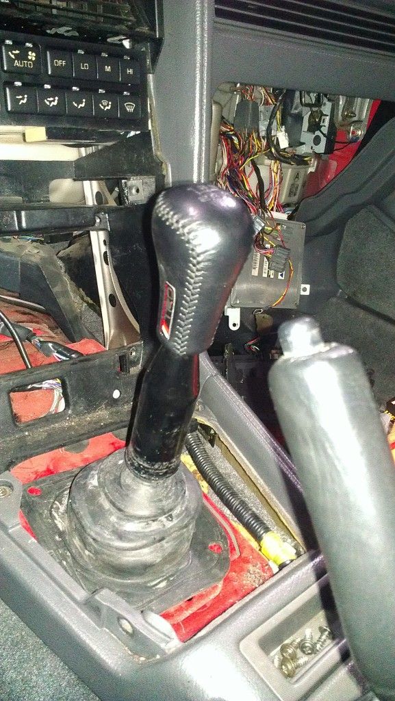

With that repaired, I was a little tired (It was 1 AM!) so I decided to see what was in the back seat. I folded the passenger seat forward, and found a genuine TRD shift knob on the floor!
